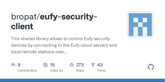

I think I used this as the extension:
and then it just worked (after a couple of restarts)
so no I dont think i use the fuatakgun one…
check out bropat · GitHub
I think this would be the best source for most troubles getting the whole thing up and running.
