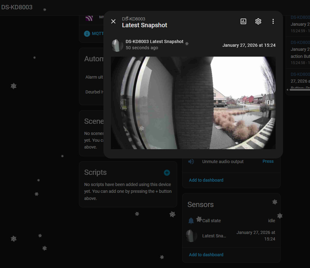

For the ones interested to try out the beta addon, i have added an image entity , you can take a snapshot , also on incoming ring event, it should create a snapshot automaticly, its also stored on the /media drive…

Hello Fabio
I use a DS-KV8213-WME1(B) doorstation.
When i press the shnapshot button, the activity says the snapshot is taken, but there is no file in /media folder of HA.
Is there any advanced configuration necessary?
Best regards
Can you look at the addon log? Was it succesfull? Do you see it on the image entity?
This ist the printout of the addon log:
2026-01-27 18:23:13.558 | INFO | mqtt_input:_take_snapshot_callback:436 - Received take snapshot command, doorbell: Videotürklingel
Nothing more then that? What beta version are you running? Can you try to enable debug mode in the system options and try again? Can you post it on GitHub instead?
I don’t use a beta version. I use Version3.0.27.
can you try stop addon, and install 3.0.0-beta.116
you can just copy over the config, and start the beta
lots of things changed in the code
test again with also DEBUG enabled
Hi Fabio
This is the log from my system. Running HA OS on Proxmox VM
> 2026-01-27 20:51:09.648 | INFO     | event:video_intercom_alarm:120 - Video intercom alarm from Doorbell
> 2026-01-27 20:51:09.648 | INFO     | mqtt:video_intercom_alarm:437 - Doorbell ringing, updating sensor
> settings: mqtt=MQTT(host='192.168.20.212', port=1883, username=None, password=None, client_name=None, use_tls=False, tls_key=None, tls_certfile=None, tls_ca_cert=None, discovery_prefix='homeassistant', state_prefix='hmd', client=None) entity=SensorInfo(component='sensor', device=DeviceInfo(name='Doorbell', model='DS-KV8113-WME1(C)', manufacturer='Hikvision', sw_version='V3.7.0', hw_version='1-0-0', identifiers='6883457586564949514587406741484950485052485750546978708151495149564953', connections=None, configuration_url=None, suggested_area=None, via_device=None), device_class=None, enabled_by_default=None, entity_category=None, expire_after=None, force_update=None, icon='mdi:bell', name='Call state', object_id=None, qos=None, unique_id='6883457586564949514587406741484950485052485750546978708151495149564953-call_state', unit_of_measurement=None, state_class=None, value_template=None, last_reset_value_template=None, suggested_display_precision=None, options=None) debug=False manual_availability=True
> topic_prefix: sensor/Doorbell/Call-state
> config_topic: homeassistant/sensor/Doorbell/Call-state/config
> state_topic: hmd/sensor/Doorbell/Call-state/state
> wrote_configuration: True
> 2026-01-27 20:51:09.785 | INFO     | doorbell:_save_snapshot_result:326 - Snapshot saved: /media/doorbell/snapshot_20260127_205109.jpg
> 2026-01-27 20:51:09.786 | INFO     | mqtt_input:_publish_snapshot_image:572 - Published snapshot image for doorbell: Doorbell
> 2026-01-27 20:51:09.786 | INFO     | mqtt:take_and_publish_snapshot:459 - Auto-snapshot published to MQTT: /media/doorbell/snapshot_20260127_205109.jpg
> 2026-01-27 20:51:14.365 | INFO     | event:video_intercom_alarm:120 - Video intercom alarm from Doorbell
> 2026-01-27 20:51:14.365 | INFO     | mqtt:video_intercom_alarm:476 - Call dismissed, updating sensor

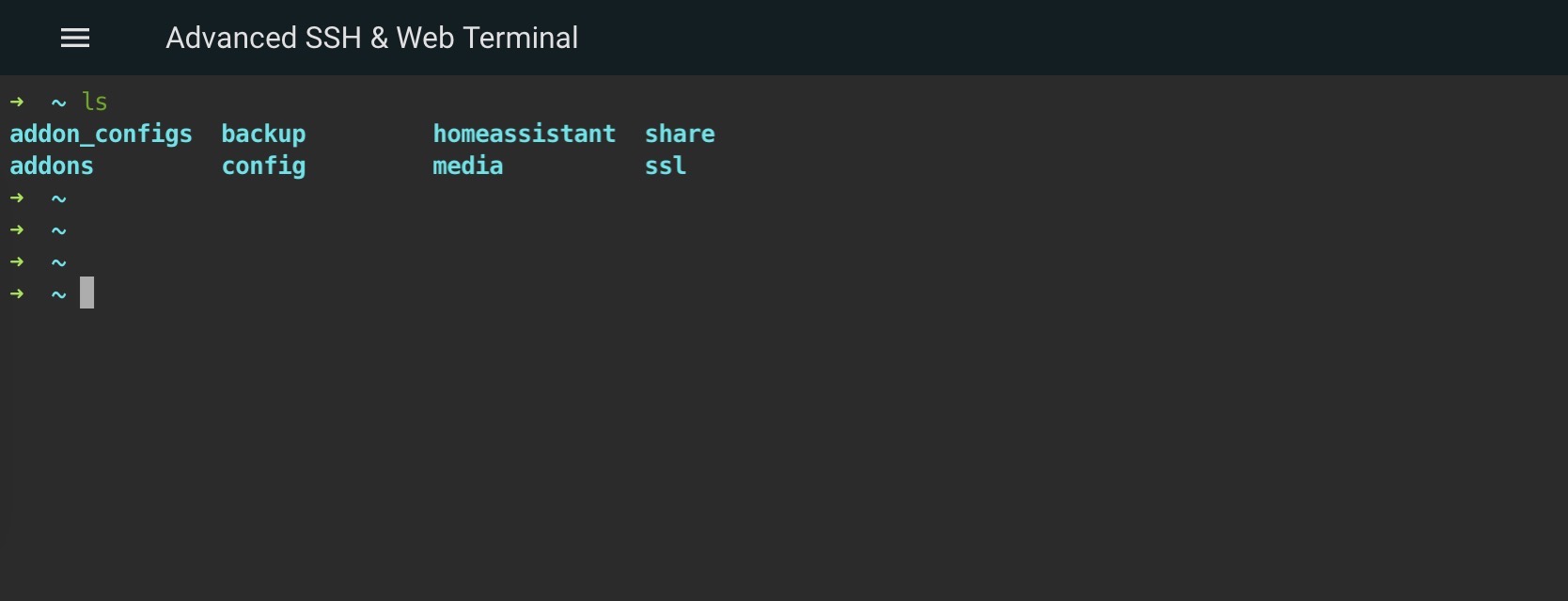

The media folder is from absolute path, not with in the Www/media folder
Perfect, it works… There is also an new image entity in the MQTT device… What model do you have?
