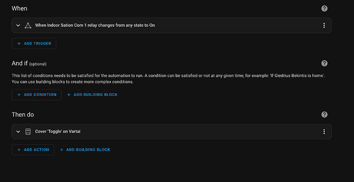

Hello, for some reason relay switches does not work for my device. Does not report Status changes nor changes statuses. Logs does not contains any relatederrors. Everything else work as expected. Any suggestions?
Hi, i see you have configured your indoor station… Its best to connect to your outdoor station instead…
If you open the door outside, it doesnt create events to indoor stations, thats normal…
I also see you are trigger the com ports, those are not for the door, you need to trigger the relay ports, but again, not all indoor devices do support open door commands
best approach is to connect to your outdoor station, indoor is limited
My Plan was to turn on relay on indoor station (button can be exposed on the indoor console), catch this event in HA and open the Gates.
yeah, catching events will not gonna work from indoor, those are coming from outdoor
Unless maybe your door lock is connected to the indoor station… but most of the time locks are connected to outdoor
Those two relay ports are not connected anywhere, i just looking for the way to trigger automation in HA from indoor station, to open the gates.
You don’t have access to outdoor station?
Do you see the relay buttons as I showed earlier on screenshot, if not, try to add this to your config : output_relays: 2
Not sure if it will work, opening doors from indoor panels, only work with newer models… maybe it works, you can try…
I have access to outdoor station and the door opening works well there. I also have automatic gates that have tuya wifi module and are connected to HA. I would like to open close those gates form Indoor console, all i need is to get event from indoor console in to HA that one of the relays was opened or closed, to engage automation that wil open the gates
I see those relay buttons they are simply not working. Triggering them from indoor station does not generate any event, also switching them in HA does not change actual state of the relays.
Hi, you will not get events from indoor, only from outdoor!
The COM relays you see are NOT for the door, try to add this to your add-on config on your indoor ![]()
output_relays: 2
That will make 2 extra buttons after a restart of the add-on, try those to open the door
