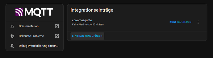

it should be created, otherwise you wouldnt see the logs
its in HA :> Settings => integrations => mqtt => “devices”
No devices or entities in my broker.
Could it be that I have configured my broker incorrectly? Unfortunately, I am still a beginner on this topic.
I found the problem. I reconfigured the broker and adjusted the password. Now it works. Thanks for the help.
