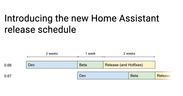

Not sure if anyone has read about HA new release schedule and the new beta period they have before releasing to everyone?
If you havnt below is a link to there blog explaining it.
