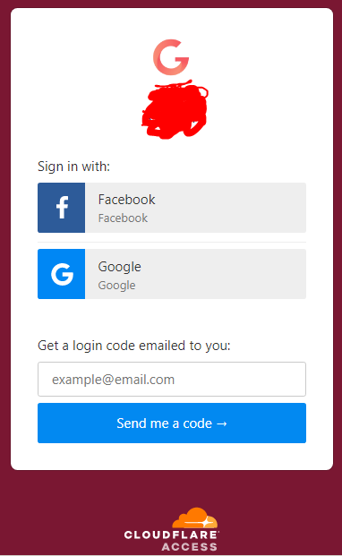

Cloudflare access. This is VERY good, but you’re limited to 5 users. Basically you can have an extra authentication step in Cloudflare, so anyone using your domain MUST authenticate. You can add exceptions to Cloudflare access, in this case I added Google API and UptimeRobot IPs as an exception so they do NOT have to authenticate.
You will run into this authentication page, you can authenticate via several methods as per below and more. I can either get a “magic” link to authenticate without putting any codes, getting a code on my email or use other methods like FB or Google authentication.
