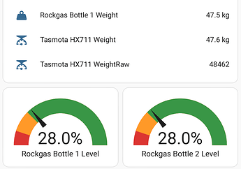

Hi All, got my 45kg gas bottle weigh station setup and working in ā€œbetaā€ form :slight_smile: using the excellent video from The Hook Up. At the moment it’s just done using some thick ply wood and roughly put together. Next steps is to fit the NodeMCU into a nice little case and sort all the wiring properly, there is a window directly above the bottles I will be able to wire it up to, so the NodeMCU box can sit inside. Then re-create the base with steel plates and create some sort of cage around the plates… so that the bottle will sit nicely on the top plate and its easy for our friendly RockGas delivery guy to load and unload without needing to explain anything to them. Once that is done and working, I’ll make another one for bottle #2.
Got the template sensors all working via:
  - sensor:
    - name: "Rockgas Bottle 1 Weight"
      unique_id: rockgas_bottle_1_weight
      unit_of_measurement: "g"
      device_class: weight
      state: >
        {{ states('sensor.tasmota_hx711_weightraw') | float - 927 }}
    - name: "Rockgas Bottle 1 Level"
      unique_id: rockgas_bottle_1_level
      unit_of_measurement: "%"
      state: >
        {{ [(((states('sensor.rockgas_bottle_1_weight') | float - 35) / 45) * 100),0] | max  }}
And…
Going to be interesting to see how this works out and then what automations I can run using the data.
Automatically ordering another gas bottle is an obvious one… however the RockGas Tauranga site uses reCAPTCHA on its form. Might be able to use the main Rockgas NZ site form.
Any other ideas?
PS: Once its all working, I’ll add it into the Energy dashboard.

How do you avoid temperature-related fluctuations? Do you see the bottle weight fluctuate over the day?
Yes I see temperature-related fluctuations, however have used some rounding to take away all the little changes and currently thinking is that ā€œit’s just a guideā€ rather than an exact measurement. I mean, before hand it was ā€œfeels like the gas bottle is emptyā€, order another one right? :slight_smile: Plus we have two bottles, so can afford for 1 to completely run out.
We only use gas for hot water and a gas hob and the gas hob uses hardly anything compared to showers and washing machine. So i’m keeping an eye on when those ā€œhigh usageā€ things occur and then looking at the temperate fluctuations after that. So far they pretty much even themselves out.
As of today and they have been monitoring for 4 days. Note the Bottle 2 is just using some different calculations to get a % from the same data. So we were at 43%, now at 35.5% - thats about 1.8% per day or a bottle every 55 days… which is kind of about right in our buying cycle.
I have also been thinking I should do manual check by putting the gas bottle on a standard set of scales once a week todo a comparison?

As a followup on my gas bottle weigh station - this seems to be working well. It’s been in for a week now and things have evened out. I ended up changing the Tasmota update time to every 60 seconds and then rounding the % entity as follows:
      state: >
        {{ [((((((states('sensor.rockgas_bottle_1_weight') | float - 35) / 45) * 100) * 2) | round ) / 2),0] | max  }}
This removed a lot of the fluctuations and evened out the graph. I have also been monitoring the weight via the weight and the weightraw sensor - so far they are the same:
I also tested the weight today using a set of scales, it was off by 0.2kg which really does not bother me in the slightest. Overall graph for the week (you can see at the end when I removed it and put it back on):

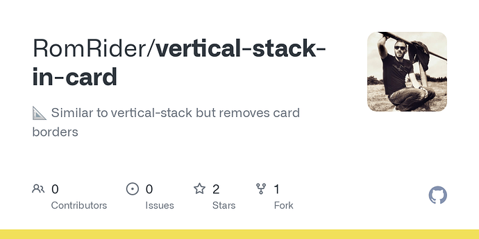

Full yaml for dashboard, some personal things/names removed. Note some of this is quite ā€œhackyā€ and I am in no means an expert in this stuff… this is my first go at a yaml based dashboard FYI :smiley:
title: Home

          - type: gauge
            name: Bottle 1 Usage
            entity: sensor.rockgas_bottle_1_level
            needle: true
            min: 0
            max: 100
            severity:
              green: 25
              yellow: 10
              red: 0
          - type: gauge
            entity: sensor.rockgas_bottle_2_level
            needle: true
            name: Bottle 2 Usage
            min: 0
            max: 100
            severity:
              green: 25
              yellow: 10
              red: 0
          - type: horizontal-stack
            cards:
              - type: entity
                name: Bottle 1 Weight
                entity: sensor.rockgas_bottle_1_weight
                state_color: false
                icon: hass:none
              - type: entity
                name: Bottle 2 Weight
                state_color: false
                icon: hass:none
