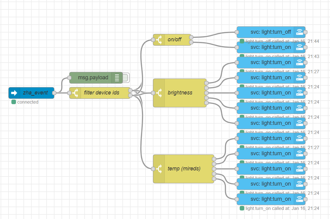

I started implementing this and decided to learn node red. it just made managing the automations a lot easier and scalable. I bought a bunch of these, so i wanted to be able to reuse my work as much as possible
here is the json of my flow
it is set up so that i have two remotes that both control on/off, brightness, and temp for a single light group. I can add another comperator to the first switch out of the events trigger so that I can add other remotes for other things
