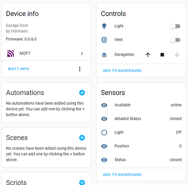

I have a SupraMatic E4 and my device looks like this in HA:
I got the Tynet RS485 Bridge without any modification. Do I need to add some additional sensors to it? Just found some in the readme of the firmware:

you need to add the sensor and reflash the board with the correct firmware for your sensors (see github)
