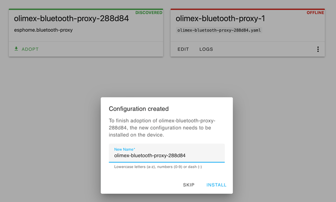

Clicking Adopt takes us to:
which can not be (remember the device has been flashed to use Lan POE, see ESPHome Bluetooth Proxy and
if one defies that, and enters the wifi credentials, one can continue alright, and a secondary devices pops up
which errors because it can Not use both wifi and Lan (also reflected in the red 'offline variant of that same device a few seconds later):
But, during that procedure, a yaml file has been created in the config, we now can edit with the reference yaml in the GitHub repo: bluetooth-proxies/olimex-esp32-poe-iso.yaml at 3d4b712885cd43f20d69d482d1d0ccc735ed5d34 · esphome/bluetooth-proxies · GitHub
the Discord discussion yought us we need to add a static IP address for the router to talk to the device, (even with MDNS enabled on the router, and working fine) so I changed that to the fixed IP address I had also set in the router on the device:

and we can click save, and install. Hooray one thinks, because there’s an initial succes reported, and the device starts logging traffic. So, close that window.
Only to find this left:
repeating the sequence makes it even worse:
so, I settled for the integration only yesterday, but would love to fix this once and for all, for future’s sake.
