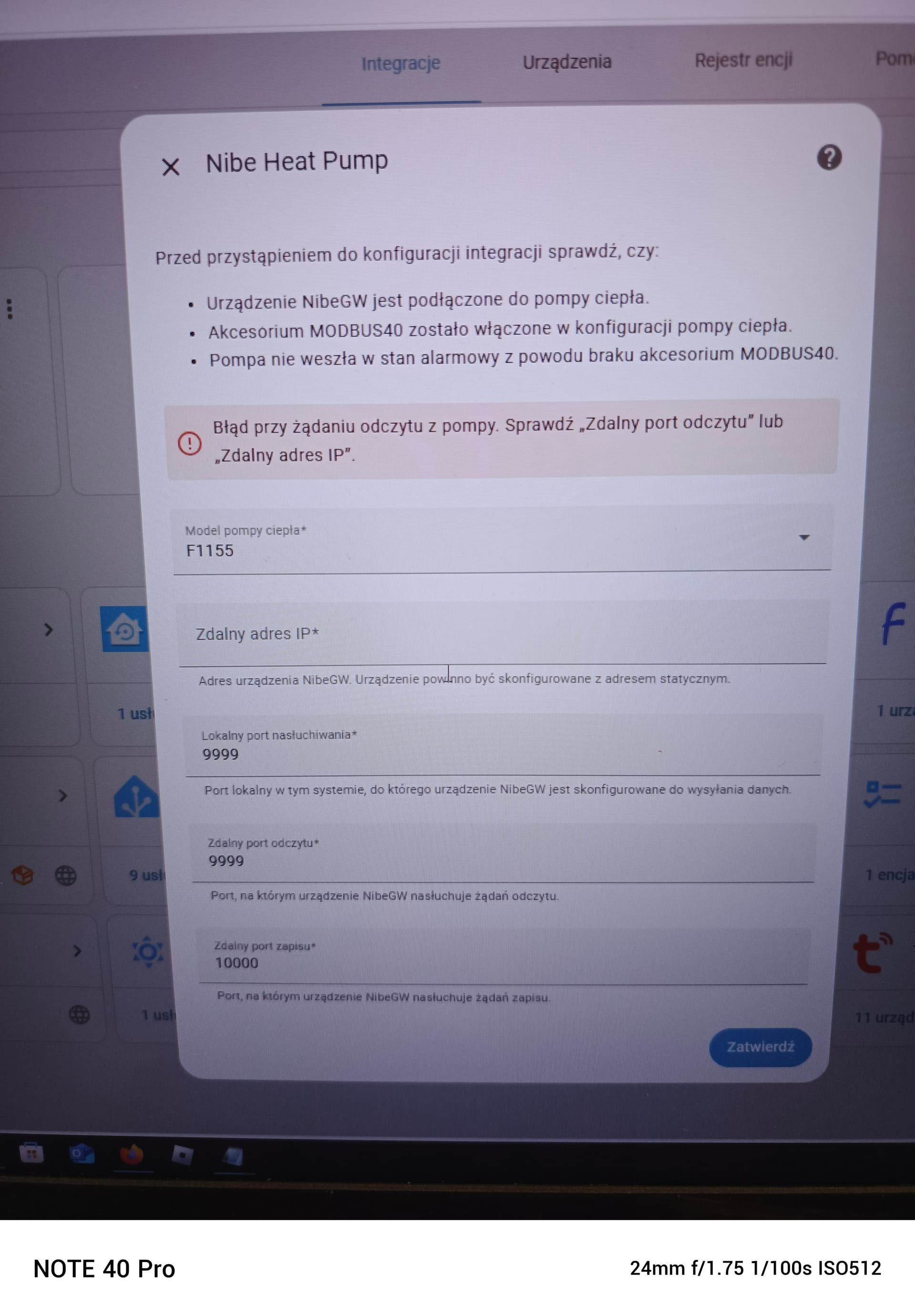

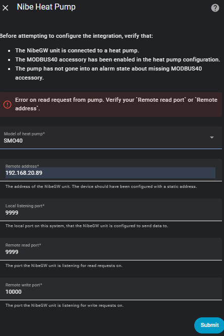

Dear all, I am trying to connect a NIBE BA-SVM 10-200 unit to Home Assistant using this integration. I built a Nibe-GW interface based on the LilyGO T-CAN485, following the example from this GitHub repository.
Unfortunately, when I try to start the integration, I get the message:
“Error on read request from pump. Verify your Remote read port or Remote address.”
The IP address of the Nibe-GW is definitely 20.89, and the ESPHome configuration looks as follows:
HA address is 192.168.20.10.
Has anyone here worked on this before? I would appreciate any advice.
I’ll just answer my own question in case it helps someone else later :slight_smile:
The issue was related to the fact that I’m running HA as a container in Synology’s Docker, using bridge mode. I needed to add port mappings for 10000/9999 (which seems obvious in hindsight :wink:), but at first this wasn’t possible because Synology reserves those ports for findhostd.
After changing the default ports to values lower than 9996, everything started working properly.
You started it, I can’t figure it out either, can you help me how you did it?
I have the same problem what to do
Of course, enter the IP esp32
As I’ve mentioned, I use HA installation as docker container working in bridged mode on Synology NAS. Bridged means here HA works like in NAT network, i.e. no ports are visible outside the container. To make HA working I had to forward port 8123, and as long as it was the only opened port in a container, there was no possibility to make nibe-gw working, as it needs it own ports to communicate with Nibe integration.
I opened additional ports for HA container. As 9999 & 10000 were used by other Synology services, I changed ports in nibe-gw config to below:
nibegw:
udp:
- ip: 192.168.20.10
port: 9994
source:
read_port: 9994
write_port: 9995
and then mapped 9994 → 9994/udp 9995 → 9995/udp to the container. Since then it works.
If you use Synlogy too, you can try that way. If not, give some more details of HA installation method.
