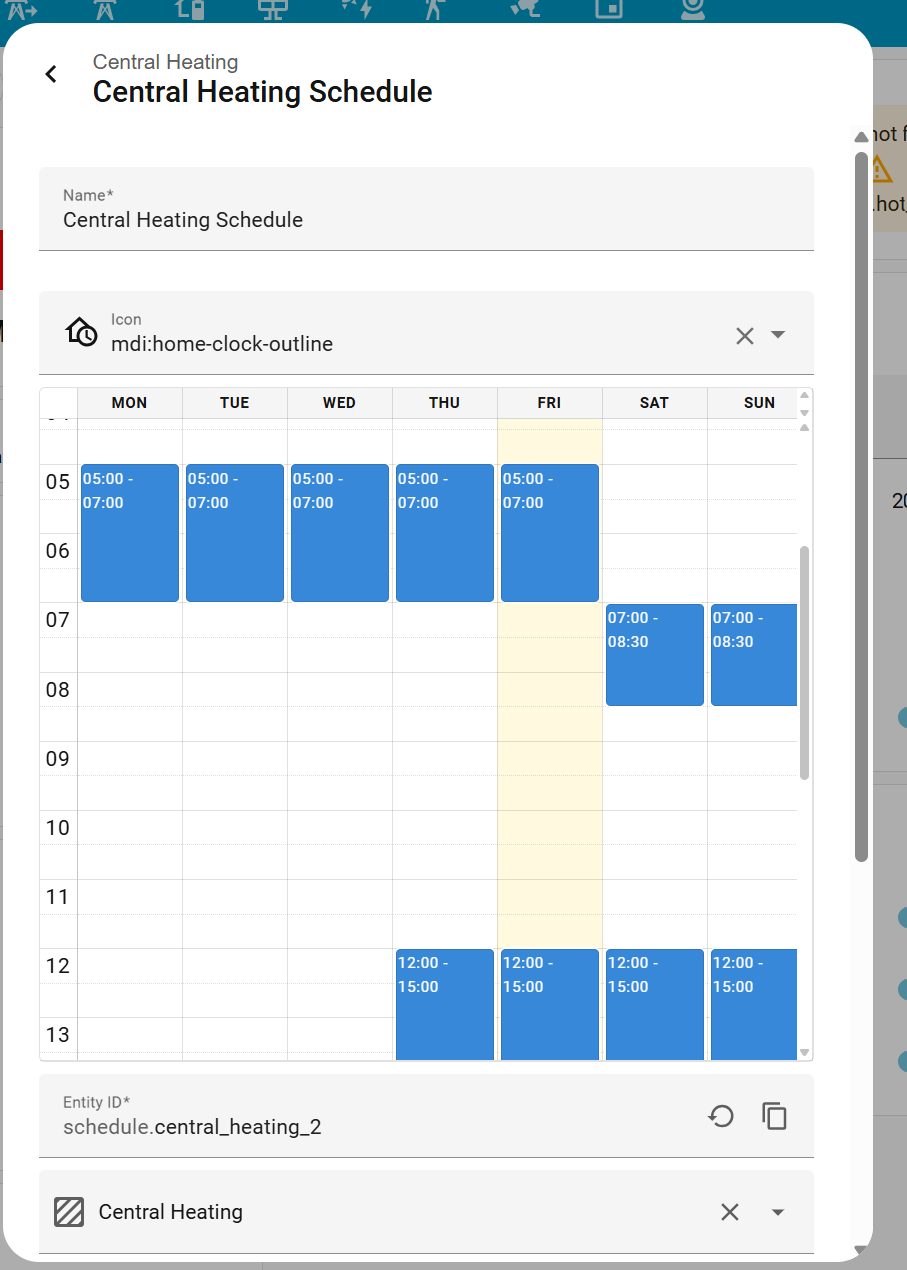

Is it possible to display the schedule in a dashboard and then be able to edit from there? I have a heating schedule set up and want to make it more user friendly for the wife to make changes rather than having to go in to the back end and possible changing the schedule name by mistake etc…
Here is the backend view of the schedule, if it could be displayed as a full dashboard panel that would be great:
I have also installed and tried the " scheduler-card" but it seems to be entity based so would required multiple entities to be added for on and for off and then multiplied by the number of climate controllers that I have (around 7) then to edit the schedule would required those same multiple number of entities to update.

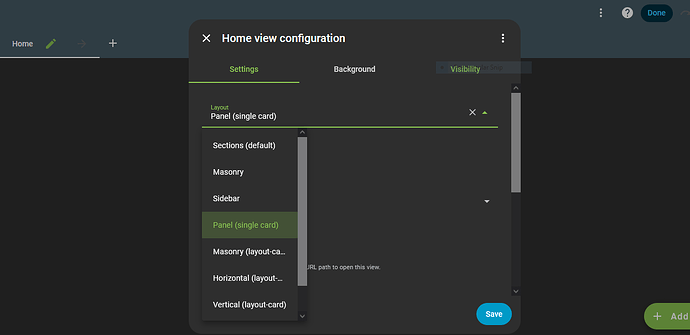

Choose Panel-View
As far as I can determin even in full panel-view there is no way to add the helper schedule to it.

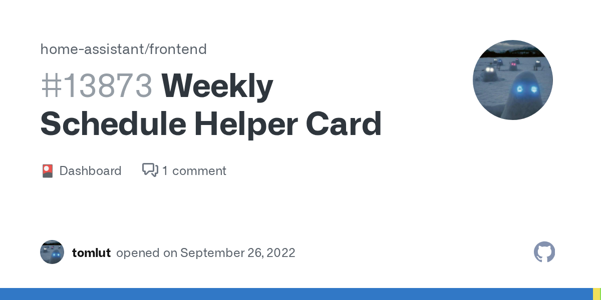

I have discovered that this feature was already requested here:
So please vote for it if you find it useful

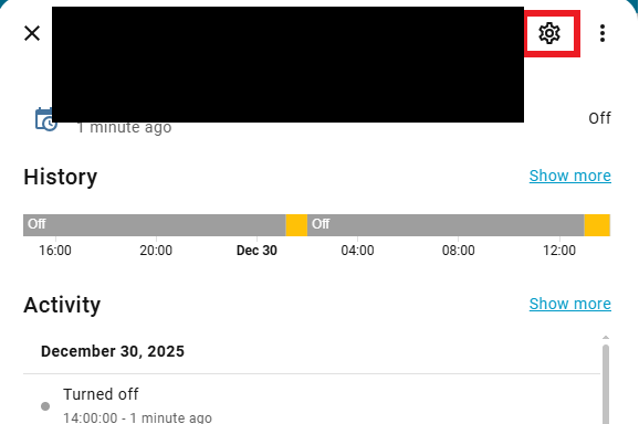

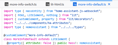

The Helper Schedule is an entity, you can place in any cards ( an modify with i.e more-info/ And using other custom:Cards and card-mod ),
Edit: But indeed cumbersome , would be more appropriate with a type Calendar-Card, dedicated to the Scheduler-entitys “settings”
I can place the scheduler entity in cards and action it with the more-info but the popup is going to show only the entity state, history and attributes. To be able to modify the scheduler you should clic in the settings button which is only available for admin users.

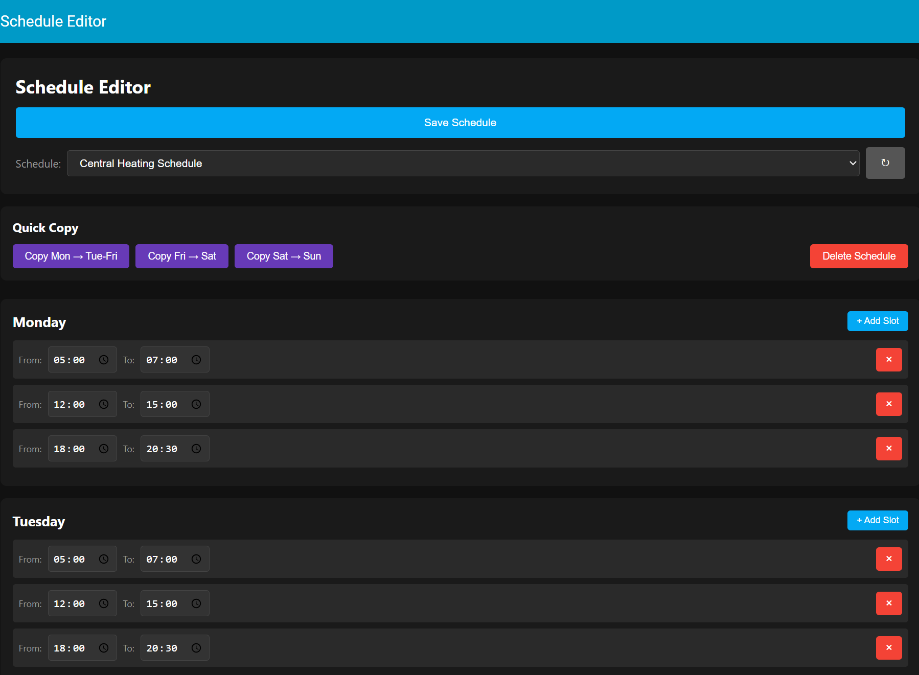

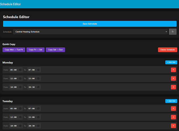

OK guys, I have created my own solution. It creates a new side bar menu item called “Schedule Editor”. When you select the Schedule Editor it opens the schedule file from the HA “homeassistant/.storage” folder (thanx to @boheme61 for pointing me in the right file direction) and you can easily edit the schedule, add additional slots, delete slots etc… On saving the changes you will get a prompt that HA s about to restart and you can accept or decline that restart. The restart is required to correctly reload the new edited schedule, it was the only way that I have found which sets the changes. I tried several other methods such as opening the clunky back end schedule editor and then using the “Update” button but that will over write your edited changes with the original version as that it the one currently “loaded” in the HA system until after a restart. I also tried out the other reload options found in the Developer section but none worked.
Its a Custom_Component so to manually install this, follow these steps.
Use the FileBrowser or File Editor tools to create folders and files as follows:
  1. Navigate to the “custom_components” folder within the Config folder.
  2. Create a new folder called “schedule_editor”.
  3. Inside the new folder create a new file called “init.py” and paste in the following code:

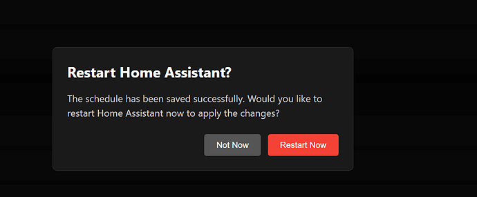

        <!-- Restart Warning Modal -->
        <div id="restart-modal" class="modal">
            <div class="modal-content">
                <h2>Restart Home Assistant?</h2>
                <p>The schedule has been saved successfully. Would you like to restart Home Assistant now to apply the changes?</p>
                <div class="modal-buttons">
                    <button class="btn btn-secondary" onclick="closeRestartModal()">Not Now</button>
                    <button class="btn btn-danger" onclick="restartHomeAssistant()">Restart Now</button>
                </div>
            </div>
        </div>

        function showRestartModal() {
            document.getElementById('restart-modal').classList.add('show');
        function closeRestartModal() {
            document.getElementById('restart-modal').classList.remove('show');

        async function restartHomeAssistant() {
            closeRestartModal();
            showMessage('Restarting Home Assistant...', 'success');
            try {
                const response = await fetch('/api/schedule_editor/restart', {
                    method: 'POST'
                if (response.ok) {
                    showMessage('Home Assistant is restarting. Please wait...', 'success');
                } else {
                    showMessage('Could not restart Home Assistant', 'error');
            } catch (error) {
                // This is expected as HA will disconnect during restart
                showMessage('Home Assistant is restarting. This page will reload automatically...', 'success');
                // Try to reload the page after 30 seconds
                setTimeout(() => {
                    window.location.reload();
                }, 30000);

  1. Create another new file and name it “manifest.json” and paste in the following:
  "domain": "schedule_editor",
  "name": "Schedule Editor",
  "version": "1.0.0",
  "documentation": "https://github.com/yourusername/ha-schedule-editor",
  "requirements": [],
  "dependencies": [],
  "codeowners": ["@yourusername"],
  "iot_class": "local_polling"
  1. go to your “configuration.yaml” file and below the “homeassistant:” section (no indentation) add the following:
schedule_editor:
Restart HA and then in your menu bar on the left you will find the “Schedule Editor”.
(Note that you will first see a non fatal error, which does not prevent Home Assistant from restarting, this is because you added the schedule_editor: to your configuration file, however until you restart and load the new initi.py file it is not available to HA. The error only occurs on first installation).
Use and enjoy!!
Some screen shots:
Sorry, just out of interest:
  • What happens on Mondays 7:00h - 12:00h and 15:00h - 18:00h, nothing, i.e. heating is turned off?
  • Do you set a temperature or is the heat ‘just on’?
  • Setting it up this way requires me to display the custom component/schedule editor in the sidebar and every change requires an HA restart?
Mean and raw , but in right direction :slight_smile: , i have no idea how you got so far (im far from a “programmer” )… but i have “some” thoughts
If you could figure out which Event is executed, when clicking the “Update-Button”, then maybe you can get around the restart.
Use the devtools in the browser, to see if you need additional imports, and can “locate” their “Uknown” path’s ( been awhile since i had fun with poking around in the backend )
Yes, Free slots, wanna book time ? :slight_smile:
@boheme61 I started liking you until you said my “rough and raw” solution… please use the like button to redeem yourself :rofl:
I have edited the inti.py file with some further scheduling copy/paste and multi schedule selector drop down functionality…
I Did ! , but now i even gave you 1 for Bringing up the Topic (again), And as you see above, there has and still been an interest for a “More Handy” Solution for this," The Feature Requests " From 22 !
I think that was about the time i lost interest for both Calendar and Scheduler, as one has to do Automations and Scripts/templates anyways, so why not “keep it all behind curtains”
In anyways and always, im in charge of my house "safety and comfort “Noone else need to know” And it’s diffinitly not something that anyone is Alowed to tamper with or Change
I have further refund my initi.py to accommodate editing of multiple schedules. My original post file has been updated. I’m now working on adding a “Create New schedule” option from within my editor, but ultimately that is already easily handled by going to the helper section and creating a new schedule from there.
HA only creates a single file called “schedule” and within that, saves multiple schedules if they have been created.
The new code provides a drop down box which lists all available schedules. Just select the schedule that you want to view and change. No changes are stored until you press the save button. Once saved, you will be prompted to allow a HA restart that is required to implement the schedule changes immediately. Otherwise you can ignore the immediate restart and continue editing your other schedules, in which case the schedule changes while saved to the schedule file, won’t be loaded in to the system until after the next restart.
                </div>
            </div>
        </div>

                                   onchange="updateTimeSlot('${day}', ${index}, 'to', this.value)">
                            <button class="btn-delete" onclick="removeTimeSlot('${day}', ${index})">×</button>
                        dayCard.appendChild(slotDiv);
                } else {
                    const noSlots = document.createElement('p');
                    noSlots.className = 'no-slots';
                    noSlots.textContent = 'No time slots';
                    dayCard.appendChild(noSlots);
                container.appendChild(dayCard);
        function addTimeSlot(day) {
            const schedule = scheduleData.data.items[currentScheduleIndex];
            if (!schedule[day]) schedule[day] = [];
            schedule[day].push({ from: "09:00:00", to: "17:00:00" });
            renderSchedule();
        function removeTimeSlot(day, index) {
            scheduleData.data.items[currentScheduleIndex][day].splice(index, 1);
            renderSchedule();
        function updateTimeSlot(day, index, field, value) {
            scheduleData.data.items[currentScheduleIndex][day][index][field] = value + ":00";
        function copyMondayToWeekdays() {
            const mondaySlots = schedule.monday ? JSON.parse(JSON.stringify(schedule.monday)) : [];
            ['tuesday', 'wednesday', 'thursday', 'friday'].forEach(day => {
                schedule[day] = JSON.parse(JSON.stringify(mondaySlots));
            renderSchedule();
            showMessage('Monday schedule copied to Tuesday-Friday', 'success');
        function copyFridayToSaturday() {
            const fridaySlots = schedule.friday ? JSON.parse(JSON.stringify(schedule.friday)) : [];
            schedule.saturday = JSON.parse(JSON.stringify(fridaySlots));
            renderSchedule();
            showMessage('Friday schedule copied to Saturday', 'success');
        function copySaturdayToSunday() {
            const saturdaySlots = schedule.saturday ? JSON.parse(JSON.stringify(schedule.saturday)) : [];
            schedule.sunday = JSON.parse(JSON.stringify(saturdaySlots));
            renderSchedule();
            showMessage('Saturday schedule copied to Sunday', 'success');
        async function saveSchedule() {
            try {
                const response = await fetch('/api/schedule_editor/save', {
                    method: 'POST',
                    headers: {
                        'Content-Type': 'application/json'
                    body: JSON.stringify(scheduleData)
                if (response.ok) {
                    const scheduleName = scheduleData.data.items[currentScheduleIndex].name;
                    showMessage('Schedule "' + scheduleName + '" saved successfully!', 'success');
                    // Show restart modal after successful save
                    setTimeout(() => {
                        showRestartModal();
                    }, 1000);
                } else {
                    const errorText = await response.text();
                    showMessage('Error saving schedule: ' + response.status, 'error');
            } catch (error) {
                console.error('Save error:', error);
                showMessage('Error saving schedule: ' + error.message, 'error');
        function confirmDeleteSchedule() {
            const scheduleName = schedule.name || schedule.id;
            document.getElementById('delete-name').textContent = scheduleName;
            document.getElementById('delete-modal').classList.add('show');
        function closeDeleteModal() {
            document.getElementById('delete-modal').classList.remove('show');
        function deleteSchedule() {
            // Remove the schedule from the array
            scheduleData.data.items.splice(currentScheduleIndex, 1);
            // Check if there are any schedules left
            if (scheduleData.data.items.length === 0) {
                showMessage('Cannot delete the last schedule!', 'error');
                closeDeleteModal();
                // Reload to restore the schedule
                loadSchedule();
                return;
            // Reset to first schedule if we deleted the current one
            if (currentScheduleIndex >= scheduleData.data.items.length) {
                currentScheduleIndex = 0;
            closeDeleteModal();
            updateScheduleList();
            renderSchedule();
            showMessage('Schedule "' + scheduleName + '" deleted. Click Save to confirm.', 'success');
            try {
                    method: 'POST'
                if (response.ok) {
                } else {
            } catch (error) {
                setTimeout(() => {
                }, 30000);
        function showMessage(text, type) {
            const msg = document.getElementById('message');
            msg.textContent = text;
            msg.className = `message ${type} show`;
            setTimeout(() => {
                msg.className = 'message';
            }, 3000);
        loadSchedule();
    </script>
</body>
</html>
        return web.Response(text=html_content, content_type='text/html')
class ScheduleGetView(HomeAssistantView):
    """View to get the schedule data."""
    url = "/api/schedule_editor/get"
    name = "api:schedule_editor:get"
    requires_auth = False
    def __init__(self, hass):
        """Initialize."""
        self.hass = hass
    async def get(self, request):
        """Get schedule data."""
        schedule_path = self.hass.config.path(".storage/schedule")
        try:
            if os.path.exists(schedule_path):
                with open(schedule_path, 'r') as f:
                    data = json.load(f)
                return web.json_response(data)
            else:
                # Return default schedule if file doesn't exist
                default_schedule = {
                    "version": 1,
                    "minor_version": 1,
                    "key": "schedule",
                    "data": {
                        "items": [{
                            "id": "central_heating_2",
                            "name": "Central Heating Schedule",
                            "icon": "mdi:home-clock-outline",
                            "monday": [],
                            "tuesday": [],
                            "wednesday": [],
                            "thursday": [],
                            "friday": [],
                            "saturday": [],
                            "sunday": []
                return web.json_response(default_schedule)
        except Exception as e:
            _LOGGER.error(f"Error loading schedule: {e}")
            return web.json_response({"error": str(e)}, status=500)
class ScheduleSaveView(HomeAssistantView):
    """View to save the schedule data."""
    url = "/api/schedule_editor/save"
    name = "api:schedule_editor:save"
        """Initialize."""
        self.hass = hass
    async def post(self, request):
        """Save schedule data."""
        try:
            data = await request.json()
            # Create backup of existing file
                backup_path = f"{schedule_path}.backup"
                    backup_data = f.read()
                with open(backup_path, 'w') as f:
                    f.write(backup_data)
                _LOGGER.info("Created backup of schedule")
            # Save new data
            with open(schedule_path, 'w') as f:
                json.dump(data, f, indent=2)
            _LOGGER.info("Schedule saved successfully")
            # Reload the schedule integration
            try:
                await self.hass.services.async_call(
                    "homeassistant",
                    "reload_config_entry",
                    {"entry_id": "schedule"},
                    blocking=True
                _LOGGER.info("Schedule integration reloaded")
            except Exception as reload_error:
                _LOGGER.warning(f"Could not reload schedule automatically: {reload_error}")
                # Try alternative reload method
                try:
                    # Fire an event to trigger schedule reload
                    self.hass.bus.async_fire("schedule_updated")
                    _LOGGER.info("Fired schedule_updated event")
                    _LOGGER.warning(f"Could not fire reload event: {e}")
            return web.json_response({"success": True, "message": "Schedule saved and reloaded successfully"})
            _LOGGER.error(f"Error saving schedule: {e}")
class ScheduleRestartView(HomeAssistantView):
    """View to restart Home Assistant."""
    url = "/api/schedule_editor/restart"
    name = "api:schedule_editor:restart"
        """Initialize."""
        self.hass = hass
        """Restart Home Assistant."""
        try:
            _LOGGER.info("Restarting Home Assistant via Schedule Editor")
            # Call the homeassistant.restart service
                "homeassistant",
                "restart",
                blocking=False
            return web.json_response({"success": True, "message": "Home Assistant is restarting"})
            _LOGGER.error(f"Error restarting Home Assistant: {e}")
