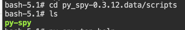

just to show what I have now:
progress, unzipped the file
and now have
Schermafbeelding 2022-06-19 om 13.27.05
or, in finder:
however, when I enter the --help command it is unknown…
Schermafbeelding 2022-06-19 om 13.29.25
or even:
Schermafbeelding 2022-06-19 om 13.31.53
so,I am almost there, but need some extra instructions please
how to find the correct --pid to record?
or should the py-spy file have an extension maybe? seems it simply isnt recognized as executable
Try running the one you extracted with ./py-spy
After you cd to the dir it was extracted to
hmmm, thats what I did.
Schermafbeelding 2022-06-19 om 15.43.32
btw, what does ./py-spy do? I never used that so maybe thats the source for issues…
also, these files now reside in the /config folder. Is that where they are supposed to be?
