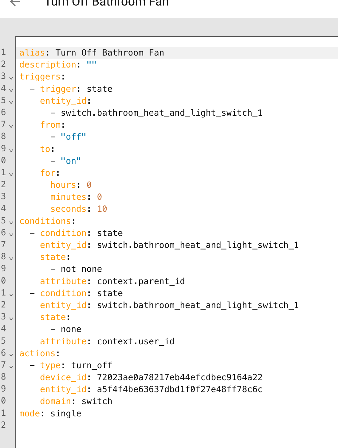

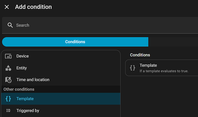

OK - here is where I am at:
- the first automation (triggering the fan to turn on when the humidity spikes) is working nicely and the fan turns on
- the second automation (triggered when the fan is turned on) is not going so well.

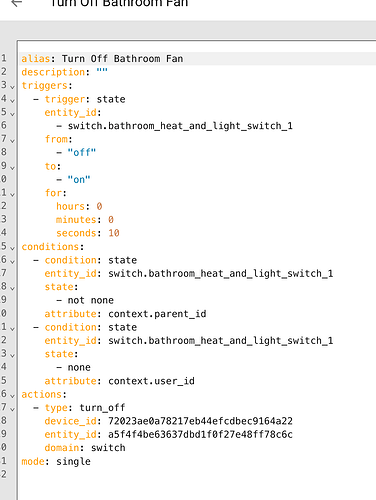

I used the GUI to create the automation and the YAML that was generated is:

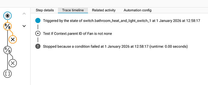

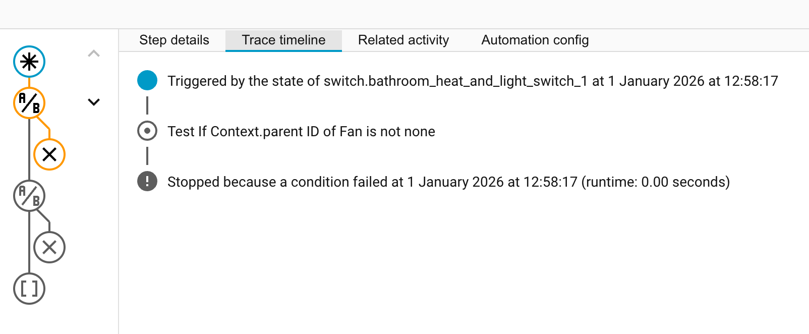

The automation fails at the first condition:

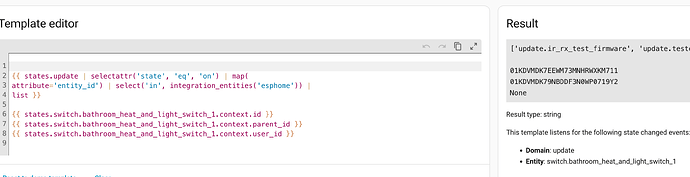

The values of the context items are:
As you can see, the parent_id is not none and the user_id is none which corresponds to the âHA Automationâ states as per @tom_l 's linked posting.
Where have I gone wrong?

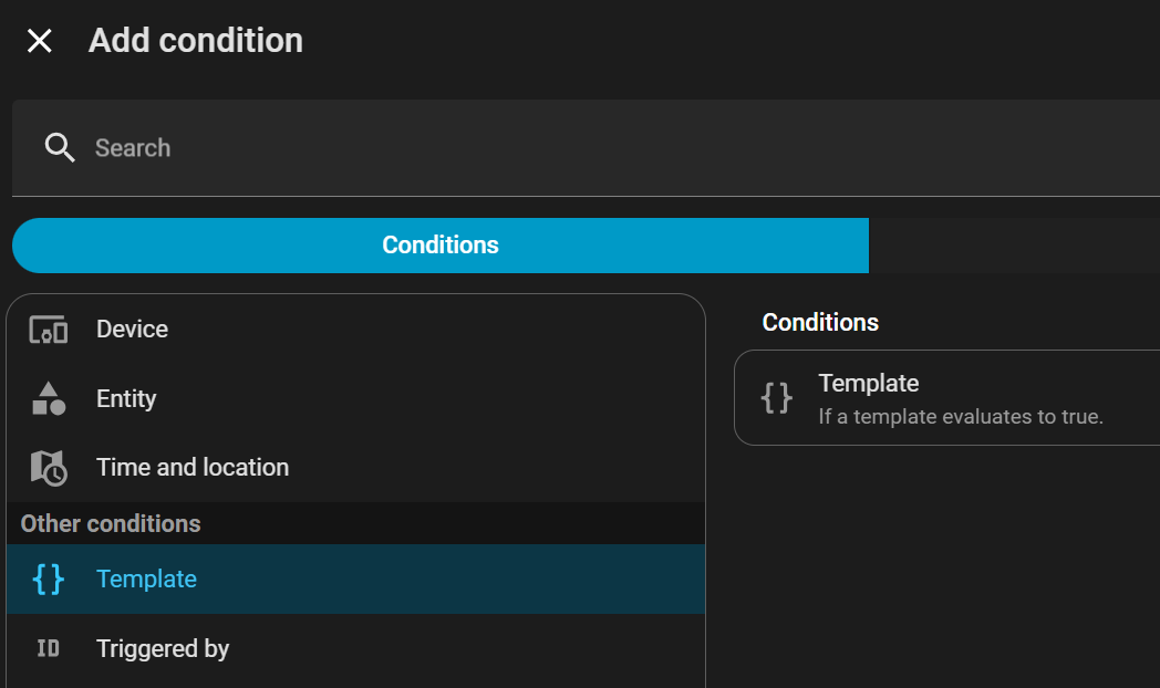

Tomâs post shows you that you need to use a template condition (available in the UI too).
You seem to have missed that part and are trying to use an invalid state condition (none / not none) using an attribute which doesnât exist (context.user_id).
Delete those state conditions and set them up as templates using the examples from Tomâs post:
