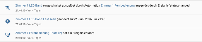

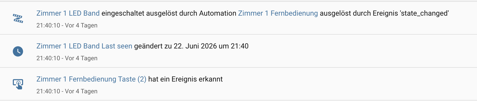

I think 2026.7 update broke this unless I'm only just now realizing... Single click doesn't work anymore and scroll is very slow.

replying again since the trace was too long, following change fixed it:
      ticks: >-
        trigger.event.data.new_state.attributes.get('totalNumberOfPressesCounted',
        1) | int }}
      action_event_type: "{{ trigger.event.data.new_state.attributes.get('event_type', 'none') }}"
instead of
      ticks: "{{ event_attr.totalNumberOfPressesCounted | default(1) | int }}"
      action_event_type: "{{ event_attr.event_type | default('none') }}"
life saver fr
The single click broke for me too since the last update to 2026.7
The fix works.
The response to changes of this blueprint with my Matter setup is painfully slow. It can take a few seconds before a toggle command is received and a brightness or scene change by turning the wheel takes up to 10 seconds or won't work at all. Does anyone have any thoughts on this?
For me switching to this blueprint helped Ikea Bilresa scroll wheel blueprint (Matter) - The Original
Thanks for reporting, was able to reproduce the issue and applied a quick fix.
Regular clicks should be working again, simply reimport the blueprint.
Blueprint version 1.3 tested with HA 2026.7.1 and Bilresa 1.9.15.
I agree, scrolling isn't exactly the fastest.
For my use case, it seems to be working well so far. I just adjust the brightness and switch back and forth between different scenes. I actually find the response time quite sufficient for that; I haven't noticed it taking more than a few seconds so far.
If dependencies on helpers or scripts aren’t an issue, have you tried the other available Blueprints? You might get better response times with them.
the latest change doesn't work for the HOLD action.
This change made it all work for me:
from:
ticks: "{{ event_attr.get('totalNumberOfPressesCounted') | default(1) | int }}"
to:
ticks: "{{ event_attr.get('totalNumberOfPressesCounted') | int(1) }}"
Explanation if anyone cares:
  • multi_press_* events carry a totalNumberOfPressesCounted attribute → this computes fine → clicks work.
  • long_press and long_release events do not carry that attribute – its event_attr had previousPosition but no totalNumberOfPressesCounted. So .get(...) returns None.
  • | default(1) does not catch None — Jinja's default only replaces undefined values, not None. So None flows into | int, which throws int got invalid input 'None'.
