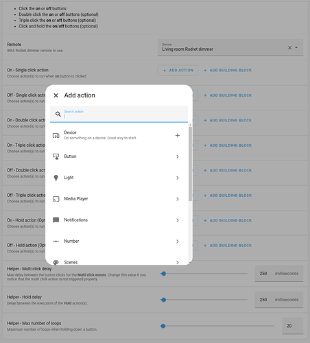

I have expanded on damru's blueprint for controlling the Rodret dimmer from IKEA, so that it now handles triple click.
It's a very simple remote with only two buttons:
Controls
    - Click the **on** or **off** buttons
    - Double click the **on** or **off** buttons (optional)
    - Triple click the **on** or **off** buttons (optional)
    - Click and hold the **on**/**off** buttons (optional)"
Actions
Every event can trigger any amount of actions:
Blueprint
Click the badge to import the blueprint:
Code
The code can be found here.

                            - conditions:
                                - condition: trigger
                                  id:
                                    - hold-off-zha
                              sequence:
                                - wait_for_trigger:
                                    - platform: event
                                      event_type: zha_event
                                      event_data:
                                        device_id: "{{ zha_remote }}"
                                        command: "stop_with_on_off"
                                        cluster_id: 8
                                        endpoint_id: 1
                                  timeout:
                                    milliseconds: !input helper_hold_delay
                                  continue_on_timeout: true
                                - if:
                                    - condition: template
                                      value_template: "{{ wait.trigger.idx is defined }}"
                                  then:
                                    - stop: button released
I have updated the code now, can you try again?
Thanks to @siros for pointing the error out :+1:
I really like your blueprint except when I dimDown it tourns the light of. How can I make dimDown to stop at 3% brightness?
I’ll look into it :smile:
Thanks, this works great for me, just thought id mention for anyone else looking for it… in the blueprint it says ‘(optional)’ for the double / triple press actions but i wanted nothing for single or double press and action only for the triple press (less chance of me or anyone else accidentally pressing the button 3 times). so i can confirm that single press is optional too.
Hi, now i have it setup and working i noticed that my rodret remote keeps doing this… ‘RODRET remote Checkin event was fired 12:23:06 PM - 25 minutes ago’ … seems to do it every hour… will this impact the battery life and is there a way to stop it? Thanks.
Thanks for this. Works great. Is there any way to increase the speed of the hold action for dimming? I have it set to ‘brightness step’ 15% when holding up or down, but the delay between steps is painfully slow. It’d be great to set it to 5% changes with a fast refresh rate
Is this only for ZHA?
It is. I could update to include Z2M, but I don’t use that myself, so I can’t test it :thinking:
@alerton123 :
I have an unused Rodret that has been doing that for a year or so. I don’t know if you can trust the battery level in diagnostics, but it says my battery level is still 100%, so I wouldn’t worry. Instead, maybe make something useful out of it, like alert you if it suddenly is NOT responding. :slight_smile:
A very late answer here, sorry :sweat_smile:
It is not possible to modify the blueprint to include this, as the action for on hold action can be set to anything - not just dimming.
But you can set the condition yourself when you create the automation using the blueprint, as I have shown here:
I didn’t think of that use case! I have added a check to verify that single click actions have been configured (v 1.4), so that you will avoid potential error logs :smile:
What about setting the Helper - Hold delay to 100 ms?
It would be awesome if you can add z2m support too
I have tried adding z2m support, but I cannot test it myself. Perhaps you can?
Not sure if blueprint broke in one of the updates but when trying to use it, the “Remote” dropdown just shows “No device available”. I have 3 RODRET in ZHA.
I’m new to Zigbee and those switches but I was able to get them exposed in Blueprint’s dropdown menu.
When you open blueprint in text editor, search for this part:
          - integration: zha
            manufacturer: IKEA of Sweden
            model: RODRET Dimmer
and replace it with:
          - integration: zha
            model: RODRET wireless dimmer
