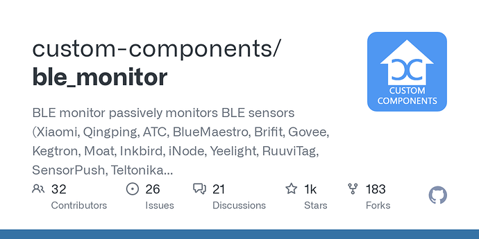

I suggest you install the Passive BLE Monitor custom integration. It supports both the iBBQ and your Xiaomi device (and a whole bunch of others):
It works fine for me with iBBQ, Xiaomi and Mi Flora devices simultaneously.
thanks, does that need the home assistant server to have a BT dongle though? Or can I use the ESP32 as a relay still?
Passive BLE Monitor supports BLE Gateway from here: https://github.com/myhomeiot/esphome-components
That way you can use an ESP32 to relay BLE packets, and do not need a bluetooth device on your HASS server.
Thanks Anders, this is working great!
