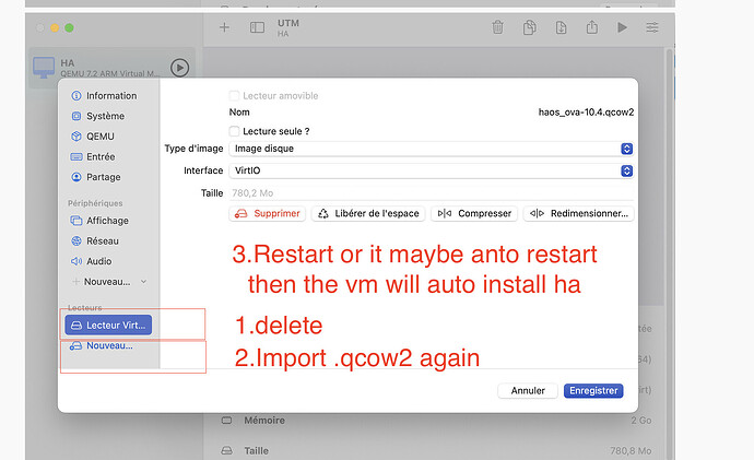

Install HA on a Mac M2 with UTM
I would like to install HA on a MacBook Air with UTM
So I installed UTM then followed the procedure
The problem is that when I launch my virtual machine I have this message
However, I seem to have set the parameters correctly.
Where did I go wrong? Thanks in advance

may you can try this, but i dont know whether is fit for your problem?
Same problem here. Nothing that I can try work

you need use aarch64 version haos_generic-aarch64-15.1.qcow2.xz
