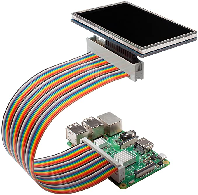

True, but⌠My raZberry is a GPIO card. Kinda hard to put away and still have it connected to the RPI
Anyway. I know I did a âdtoverlay=pi3-miniuart-btâ on my RPI3 (running from SD card) and it works.
Unfortunately when booting from SSD you dont have the /boot folder so you can edit the config.txt file.
I still hope that there is some other way to do this.
