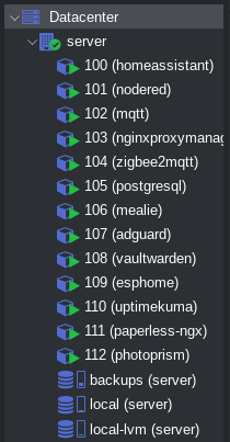

I prefer the detached method :wink:
Screenshot 2022-09-20 3.59.29 PM
