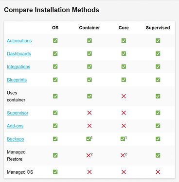

Do yourself (and this community) a favor and install Home Assistant OS on your Pi. There is nothing you will miss compared to the HA Supervised method which is considered advanced and should only be used if you are an expert in managing a Linux operating system, Docker and networking! Obviously you are not there yet.
no,I put my nmcli with the mod, and not the one from crhis 1989, the problem with using the home assistant os is that I try to integrate a voltronic inverter and it doesnât work, but with the ha docker I can install serial cable packages
