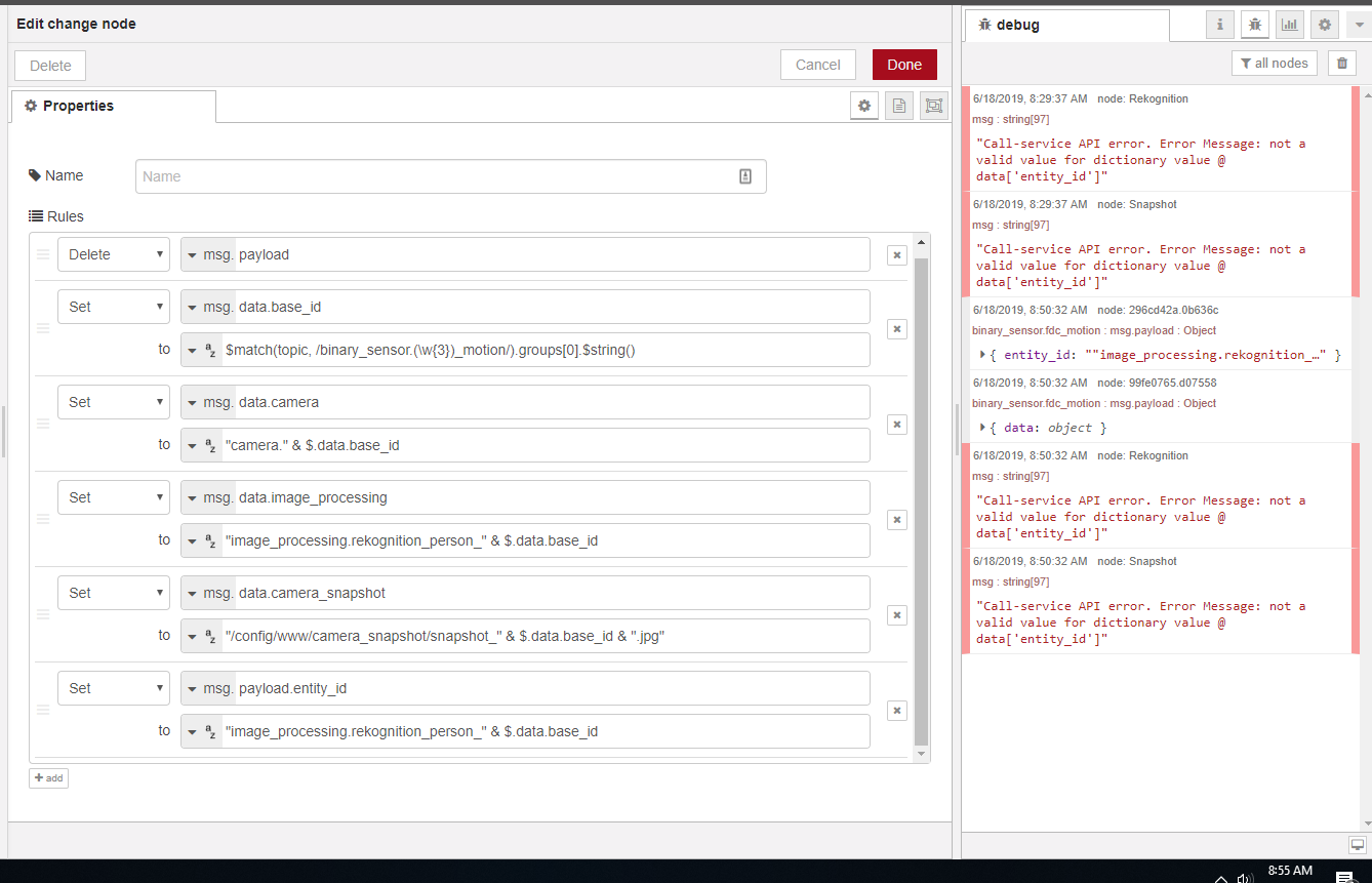

Convert Node
The next node listed as Convert is change node that will modify the details in the payload. I’m not going to delve into the logic behind it, but it’s basically adding or changing a bunch of values to reflect the 3-letter name of the camera and the corresponding image detection components. This was by far the most difficult part to get correct when I was building this. It looks like this:
Please note that you’ll need to specify JSONata for the to field. I’ll paste these in order:
DELETE:
payload
SET:
data.base_id
$match(topic, /binary_sensor.(\w{3})_motion/).groups[0].$string()
SET:
data.camera
"camera." & $.data.base_id
SET:
data.image_processing
"image_processing.rekognition_" & $.data.base_id
SET:
payload.entity_id
