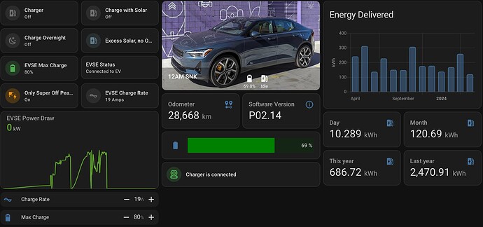

I’ve been using this for a few months and it has been working great! Having this has enabled me to add some functionality that I didn’t have before.
  • I can now control the Charge Level by setting the Polestar 2 to 100% and watching the SoC via this integration to stop the charge from my EVSE
  • I can detect when the EVSE is connected to the car. I was able to do this before with my Emporia EVSE through some templating, but having a second source works great for triggering Actionable Notifications
  • I can more reliably use Excess Solar Charging by also leveraging the SoC sensor
I’ve updated my dashboard to look like this:
The ability to set the Max Charge remotely is my favorite
