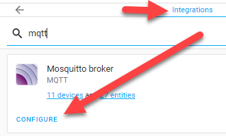

Hi, I’m a bit stuck and I can’t find what’s not working.
In Home Assistant:
One example of how I am calling it from HA:
- platform: mqtt
name: "My Computer - Current User"
state_topic: "iotlink/workgroup/w-s4su3841/windows-monitor/stats/system/current-user"
unit_of_measurement: ''
icon: mdi:account
value_template: "{{ value }}"
availability_topic: "iotlink/workgroup/w-s4su3841/lwt"
payload_available: "ON"
payload_not_available: "OFF"
qos: 1
Any suggestions?
Can’t see anything wrong here. But I do have a few questions.
value_template on this example, because without a template the state is a string of whatever is published to that topic.Thanks. I went down the rabit hole of checking everything and I realized that my mosquito broker in integration in home assistant was… wrong. I used Nodered as a standard so I never thought about checking there. It works now. Thanks!
