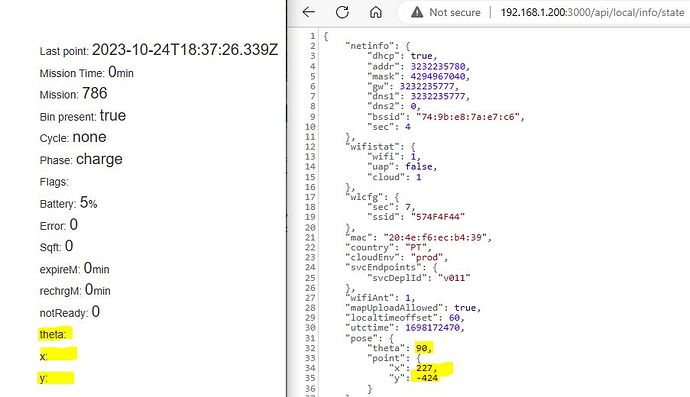

I can see the location of the robot on /api/local/info/state but not on the map page.

if the pose data is there, then in theory the map generated in this addon should be generating?
