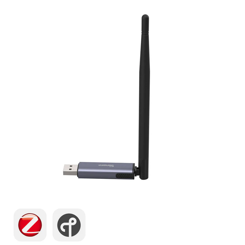

ITead’s new “SONOFF Dongle Plus MG24" based on Silicon Labs EFR32MG24 radio microcontroller SoC has now been launched
FYI, ITead just released a new “SONOFF Dongle Plus MG24”, a Zigbee Coordinator USB adapter (and optional Thread Border Router) based on the newer ERF32MG24 radio MCU from Silicon Labs, as an improved version of their previous “Sonoff ZBDongle-E” (based on EFR32MG21) which out-of-the-box is compatible with both Home Assistant’s built-in ZHA integration (Open Home Foundation’s officially supported Home Assistant native Zigbee gateway based on the zigpy project) as well as the just as popular third-party Zigbee2MQTT application. See:
This model ships with a USB-extension-cable (which is really a must to use as explained below):
Being based on a faster Silabs EFR32MG24 chip (instead of the EFR32MG24 chip that the previous “Sonoff ZBDongle-E” was based on) means this new Zigbee Coordinator adapter has more resources (onboard CPU, memory and storage) so it will technically be able to handle a larger Zigbee network with more devices connected, and in theory aslo be a faster and a little more future proof, (though it should be noted that Silabs also have an even better latest-generation radio microcontroller available that is called EFR32MG26 which have even more memory and storage resources) and is what I personally would call “future-proof” (hence this public product request to Itead/Sonoff → [NEW HARDWARE REQUEST] Silicon Labs EFR32MG26 based Zigbee Coordinator USB adapter from ITead/Sonoff? · Issue #39 · itead/Sonoff_Zigbee_Dongle_Firmware · GitHub ).
While each model of newer chips from Silabs have improved RX Sensitivity (better dBm signal reception), the main valid technical arguments for wanting a new Zigbee Coordinator USB dongle radio adapter is perhaos the EFR32MG21 MCU which has less RAM and Flash Storage resoucres so is therefore limited to connecting around 200 connected Zigbee devices at most, and the EFR32MG24 MCU have twice the Flash Storage and three times as much RAM so should in theory be able to handle around 400 connected Zigbee devices. If that is the case then the even newer EFR32MG26 have more than 5-times the RAM and 30-times as much Flash Storage as the EFR32MG21 so any upcoming adapters based on the EFR32MG26 will in theory be able to handle at least 1000 connect Zigbee devices, (that said it should be a bigger leap for a user to upgrade from a EFR32MG21 directly to a EFR32MG26, but then again you can always reuse all of these dongles as best-in-class Zigbee repeaters by simpy flashing them with Zigbee Router firmware).
Anyway, this EFR32MG24 based “SONOFF Dongle Plus MG24” is still sold at such a very low price (this and previous USB radio dongle variants still look to be great value for the hardware you get at this low price) so I can assume ITead sell it at cost hoping to make money on attach rate sales, so if new to Zigbee then suggest you also check out all of the other Sonoff branded Zigbee devices as well (with exception of their own bridge/gateway products which I personally do not recommend when you can instead use Home Assistant’s native ZHA integration or Zigbee2MQTT and help the open-source community building those by reporting bugs or even assist with their development).
I personally use almost all of Sonoff battery-operated Zigbee devices and can recommend them however still suggest you do your own research and read articles by independent reviews for more information and practical tests. Also, I can personally recommend using their previous USB adapters flashed as Zigbee Routers to use as dedicated Zigbee repeaters.
TIPS!
  • If you are already using the Home Assistant’s ZHA integration with an older Zigbee Coordinator USB radio dongle then it is super easy to migrate to a newer Zigbee Coordinator USB radio dongle, just follow these steps in the ZHA integration documentation → https://www.home-assistant.io/integrations/zha#migrating-to-a-new-zigbee-coordinator-adapter-inside-zha
  • The fact that ITead now sell a “SONOFF Dongle Plus MG24”, an “Sonoff ZBDongle-E” variant and a “Sonoff ZBDongle-P” variants of similar looking adapters with practically the same functionallity can be a little confusing as they can all either can act as either a Zigbee Coordinator (by default) or a Zigbee Router device (if flashed with such firmware instead), or even a Thread Boarder Router (if flash alternative OpenThread/Spinel Radio Co-Processor (RCP) firmware to enable Thread network protocol for allowing Home Assistant to be used as a native Matter controller).
  • As more companies now sell similar adapters users will now have more options as different DIY home automation software applications offer might not be fully compatible with one or the other (Home Assistant’s ZHA integration and Zigbee2MQTT are today fully compatible with all so based in just the specification the older ones should in theory offer similar performance on paper while the newer MG24 model should be able to handle a larger amount of connected devices).

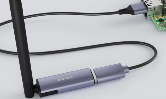

  • To avoid EMF/EMI/RMI interference it is strongly recommended use the included USB extension cable or even least buy a longer USB extension cable to get the Zigbee Coordinator / Thread Border Radio adapter a bit away from all sources of electricity and electomagnetic noise that will interfere with signal reception (which included the computer/appliace that runs Home Assistant). Again, it is higly recommended to follow all the general tips in the community guide about Zigbee network optimization: a how-to guide for avoiding radio frequency interference + adding Zigbee Router devices (repeaters/extenders) to get a stable Zigbee network mesh with best possible range and coverage by fully utilizing Zigbee mesh networking as all Zigbee Coordinator adapters is very sensitive to EMI/RFI interference (e.g. a noisy radio frequency environment will jam the signal and prevent it from receiving all Zigbee messages to it without errors). Connecting the dongle via a long “shielded” USB extension cable in a USB 2.0 port or USB 2.0 hub (and not a USB 3.0 port) to get it away from EMF sources will usually help a lot if experiencing connection or pairing symptoms/issues.
    • Another reason for using an USB extension cable is that the USB-plug design of ITead’s Sonoff USB dongle hardware adapters can be a little short and wide which makes it harder and sometimes impossible to plug it into some USB ports if the computer enclosure/chassis/casing is to thick around the USB-port as that will physically prevent the USB dongle from actually making a proper connection inside the USB port even if it looks like it is plugged in all the way that is possible.
      • Some people have even taken a Dremel to make these type of USB radio dongles fit without using a USB-extension cable, meaning that actually taken the bad decision to power-drill or other power-tool to physically modify the Home Assistant Blue chassi/enclosure to fix the issue of sunken USB-ports, see this picture what not to do (as instead you should use an USB-extension-cable):

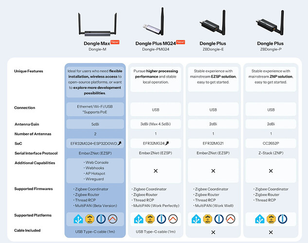

@Ash.xiao spotted now on the website that Sonoff/Itead offers “MultiPAN” (Multi-PAN) firmware for this new SONOFF Dongle Plus MG24 adapter, therefore I would like to point out that neither ZHA or Zigbee2MQTT developer recommended or support the use of Multi-PAN RCP (RCP Multi-PAN) firmware for a Zigbee Coordinator in a multiprotocol configuration on a single physical dongle, and as such I would suggest that Sonoff/Itead remove the mentioning of it as using a multiprotocol configuration with Zigbee and Thread network running at the same time on the same radio is very experimental even it technically works, or at least clearify that OpenThread Multi-PAN CPC (CPC Multi-PAN) firmware should only be used when will just using the dongle as a Thread Border Router. It is instead higly recommended to just buy two separate dongles and use one dedicated as Zigbee Coordinator adapter and the other one as a dedicated as Thread Border Router adapter. For reference read this discussion with arguments against using Multi-PAN for Zigbee:
Neither ZHA or Zigbee2MQTT officially support running multi-protocol (Zigbee and Thread at the same time)
Multiprotocol firmware is not supported. The recommended alternative to establish multiple networks is to use one adapter per protocol.
“Multiprotocol will remain an experimental feature and is not recommended for use.”
Thank you, @Hedda. Make corrections and add additional information to the Dongle-PMG24 comparison chart.
  • Radio SoC/MCU chip: Silicon Labs EFR32MG24(efr32mg24a420f1536im48)
  • USB to UART/Serial Converter Chip: CP2102N
  • USB EEPROM Product Description ID: SONOFF Dongle Plus MG24

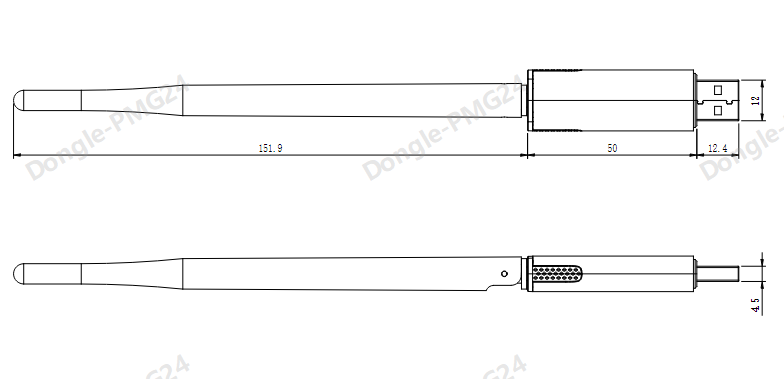

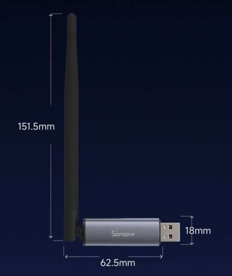

@Ash.xiao Can you tell us if the external antenna is replacable or no? And if the antenna it ships with is both rotatable and tiltable? Looking at the pictures it seems to only tiltable and not replacable, or?
Also wondering about the measurements of the device, both the enclosure lenght and width, as well as the antenna lenght, do you have more detailed specifications?

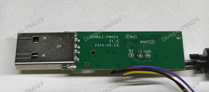

Could you perhaps even post some pictures of the circuit board inside without the enclosure? Both sides of the PCB?

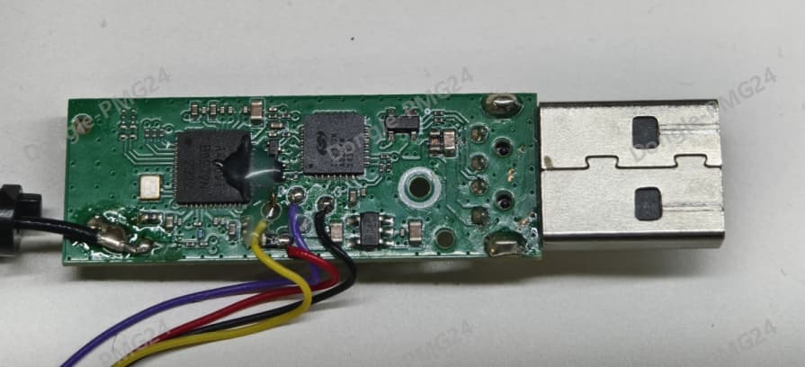

Of course. The external antenna is not replaceable, but it can be tilted up to 90 degrees and rotated up to 180 degrees.
The following are the product dimension drawings and internal PCB layouts.
The device comes pre-flashed with firmware version 7.4.5 Zigbee NCP (EmberZNet 7.4.5), with a baud rate of 115200.
The firmware was built using Silicon Labs’ official Simplicity Studio v5 (IDE). Its configuration remains largely consistent with previous ZBDongle-E firmware versions, with optimizations such as an increased receive buffer size.
For users who wish to build the firmware themselves, here is some additional information:
Crystal Frequency: 38.4 MHz
Pin Mapping:
TX = PC01
RX = PC02

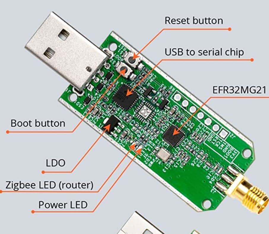

@Ash.xiao Only solder pads and no buttons on the PCB for Bootloader (“Boot button”) and resetting (“Reset button”) to make it possible to recover a bricked device in case the user flash wrong firmware or firmware writting gets corrupt? Will you document how to use the boot pad and/or reset pad for bootloader recovery?
Both the Sonoff ZBDongle-E and the Sonoff ZBDongle-P had “Boot” and “Reset” as buttons:
Under normal circumstances, as long as the bootloader is not damaged, users can flash back the official firmware using the SONOFF Dongle Flasher even if the wrong firmware was previously installed.
Due to its unique circuit design, the SONOFF Dongle can control the output of high and low levels from the serial chip via the USB port, allowing the device to enter bootloader mode — serving as an alternative to a physical button. This is also a key advantage of the SONOFF Dongle Flasher compared to other web flashers.
A practical example: the SONOFF Dongle Flasher can force a device running router firmware into bootloader mode, making it possible to reflash it with coordinator firmware. Compared to other web tools that require physically shorting pins or rely solely on software methods to enter the bootloader, this approach is significantly more reliable.
In cases where the bootloader is corrupted, even a physical button would be of no use. The only recourse is to solder wires to external pins and perform a wired flash using a tool such as a J-LINK.

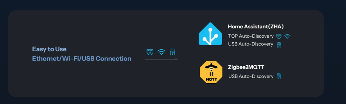

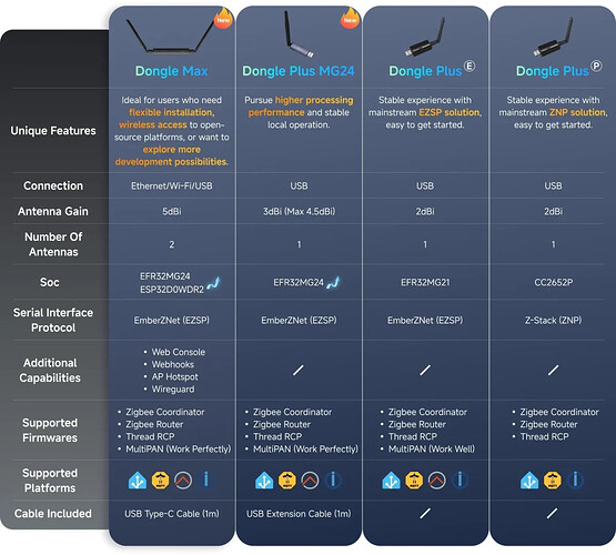

Hello @Hedda , for your information.
The SONOFF Dongle Max is now available.
SONOFF Dongle Max Zigbee/Thread PoE Dongle | Dongle-M

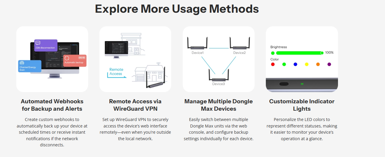

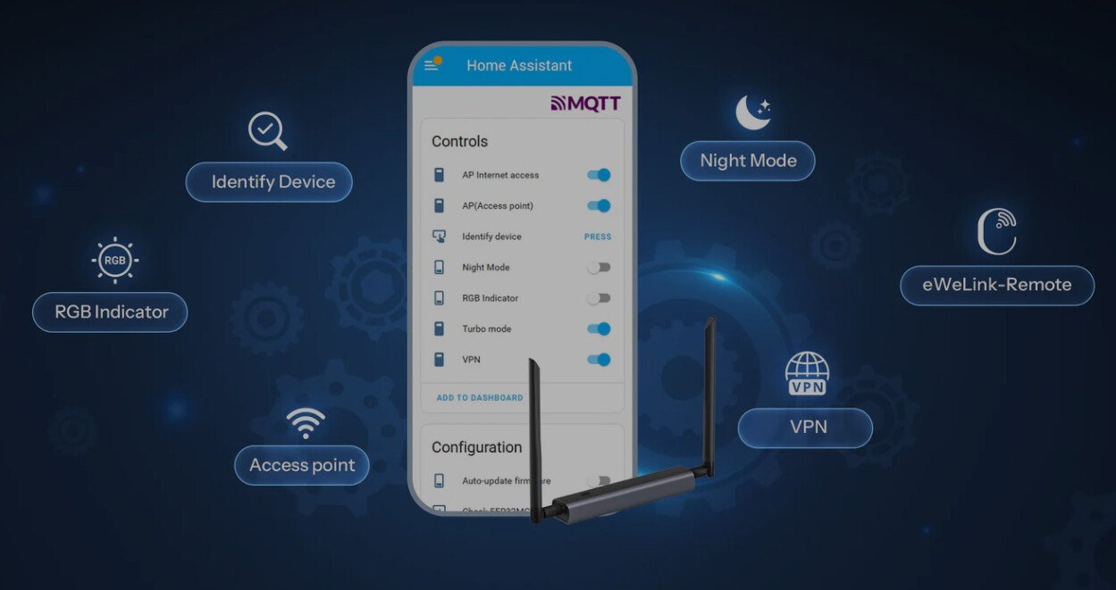

@Ash.xiao again I would really really really recommend that Sonoff disable both WiFi and VPN on it by default if and when using it as a Zigbee Coordinator adapter!
As far as I understand that the Thread protocol does not have this issues with packet drops or latency but users who use it as a Zigbee Coordinator will have problems, however not all the time, which makes troubleshooting even harder. This will also increase the support burden on application communities who will get more reports of people that have intermittent issues du to WiFi or VPN connection causing problems for them.
WiFi and VPN are as such very bad idea to offer for Zigbee Coordinator adapters and problems with it could risk ruin the reputation of not only Sonoff but also applications like ZHA and Zigbee2MQTT who users might blaime.
I would suggest that you make it very clear in both marketing (websites and user guides/manual, etc.) as well in the firmware configuration that using it as a Zigbee Coordinator adapter over Wi-Fi or VPN is not recommended. Personally I would not recommend an adapter to anyone unless it is made very clear that they should never ever use it as a Zigbee Coordinator adapter over WiFi or VPN.
Those using a Zigbee Coordinator adapter over a Wi-Fi or VPN connection are almost all but garanteed to have a bad experience and get issues sooner or later if they use it as a Zigbee Coordinator over WiFi and/or VPN.
Please see repeated warnings below and be warned. Using a Zigbee Coordinator adapters should really only ever use a wired Ethernet connection that is 100% stable and always online without latency or congestion.

Note! Multi-PAN /multi-protocol is also not recommended so should not be promited either! See:
PS: Regardless, I think it would have made a better product if it did not have WiFi or VPN at all.

FYI, this is otherwise seriously bad marketing, and could even be called false advertisement and is actually illegal in some countires that have stong consummer right protection laws (such as the EU and Scandinavia), as as Sonoff is selling directly to those countries you could be breaking the law by not declaring this limitation up front.
Today there is nothing on those webpages to indicate that Zigbee Coordinator over WiFi or VPN is a bad idea. Instead the webpages promote it and make it seem like it would be a good idea.
I highly recommend that you simply remove any mention of WiFi and VPN from all your pages!
  • SONOFF Dongle Max Zigbee/Thread PoE Dongle | Dongle-M
    • " 【Flexible Connectivity Options 】Supports Ethernet, Wi-Fi, and USB connections, giving you the freedom to deploy Dongle Max wherever it fits best. Even when your Dongle is far from the router, wireless access keeps it connected."
PS: I understand that Sonoff have seen that other manufacturers added WiFi and VPN so therefor maybe thought it be a good idea, but that does not mean that using it as a Zigbee Coordinator over WiFi and VPN is not a bad idea. If you want to make good use of the ESP32 chip then maybe see if could use use it Bluetooth Proxy (like ESPHome and Shelly does):
