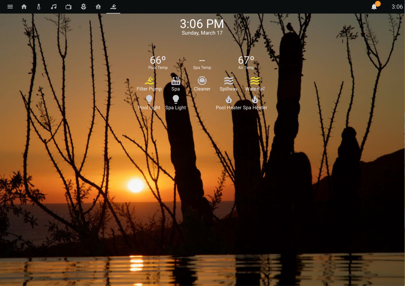

Attaching a pic of my new pool tab, thanks to you!
I like the look of your tab, I haven’t given much time to mine besides having my sensors/switches in separate pool/spa cards :slight_smile:
You’re right, I have the set temperatures. I will have a look at that after I add support for the dimmable lights. It might be tricky to test but it shouldn’t be too difficult to implement.
