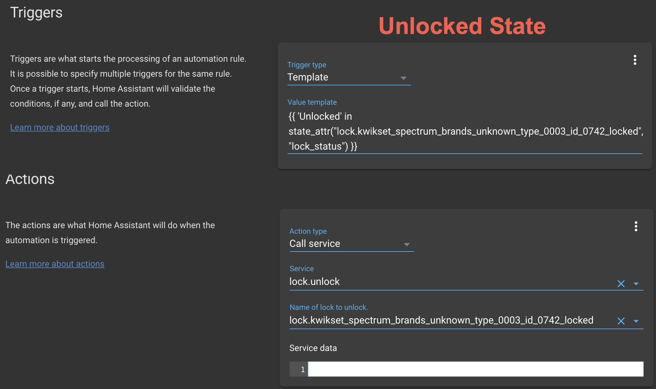

Initially, I came here to the Home Assistant forums looking for a solution and found that the whole codes list approach which I didn’t like, so I came up with a templates approach using Automations. BUT BEFORE you use this, the solution that @blee posted is absolutely the best solution in my opinion, and I’ve since then removed my automations and used @blee’s approach, which I’ll show in detail how to do below.
Here is the automations solution using templates, it’s not perfect and sometimes if you lock/unlock the door to quickly it gets stuck in a loop, unlocking and locking the door until I reboot Home Assistant which is not acceptable to me for a long term solution. But, it’s cleaner then the codes so if anyone wants to use it, here it is.
And here is the config for unlocked.

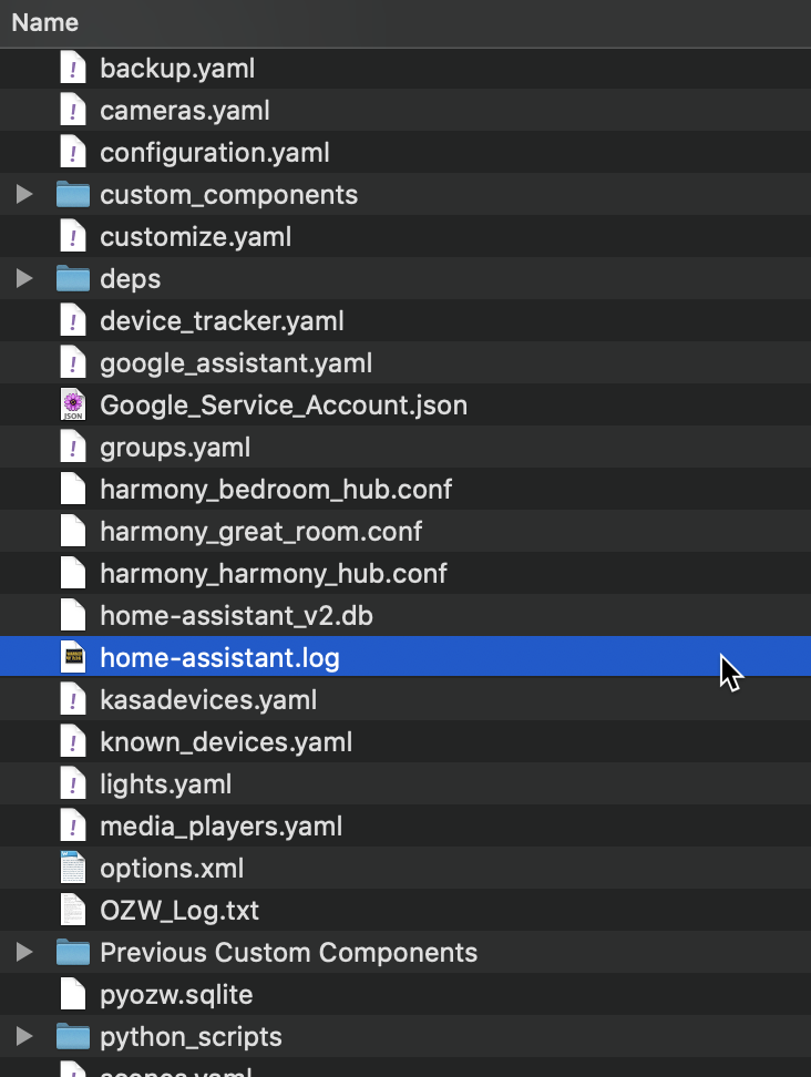

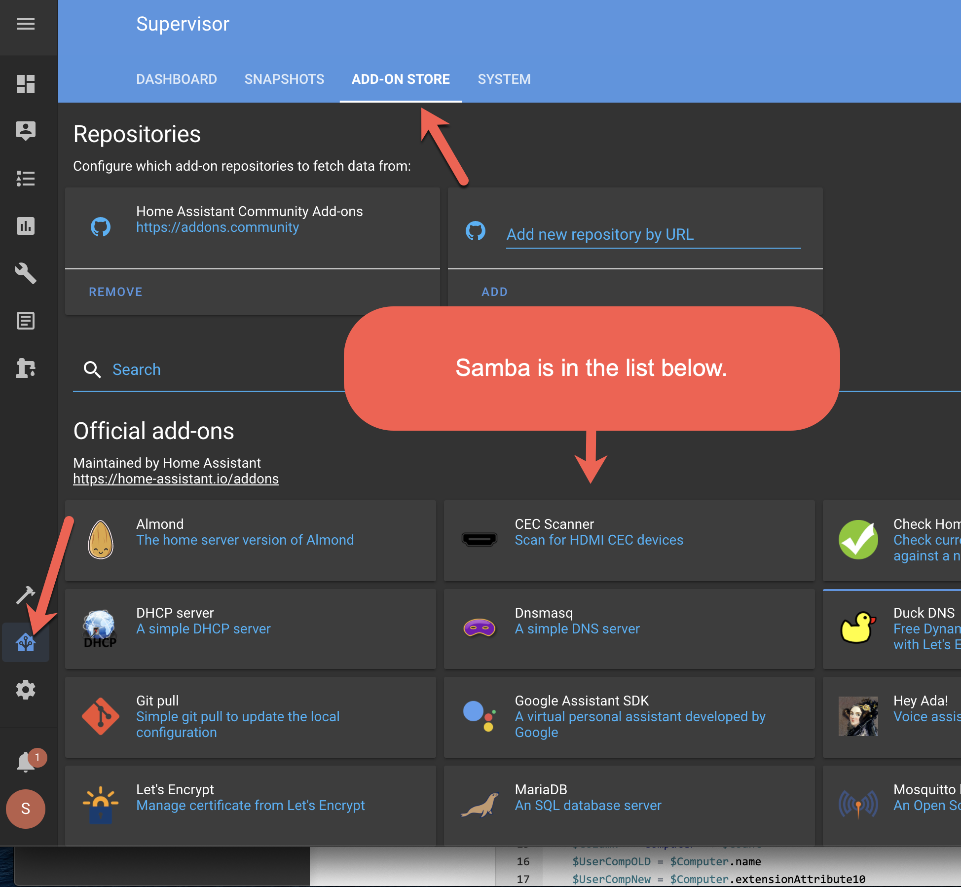

  1. Open your HASS Logs (You need a log viewer or file system access installed to do this) I would suggest the file system approach which is Samba since you’ll need it anyway for the later steps, you can install it from your Home Assistant Supervisor section.
  2. Identify your Z-Wave IDs: Navigate to Configuration>Zwave>Select your lock node>Print Node
  3. Connect via Samba and open your logs file.
  4. Search the string in your logs for manufacturer_id and product_id and write them down. The logs are long so expected a huge wall of text.
