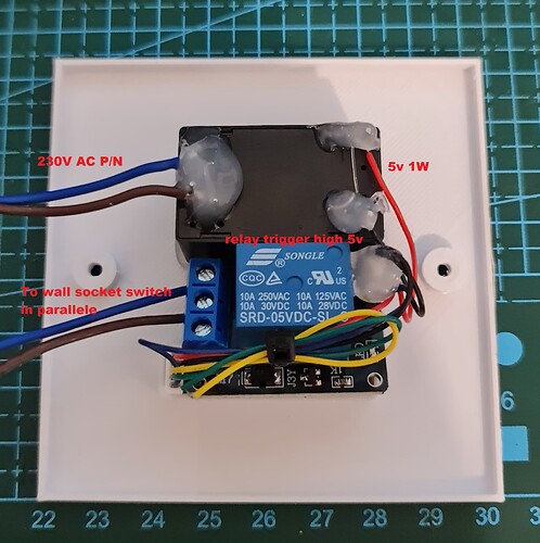

i have make a standalone LD2410B with relay and power supply to lighton/off automatically, all included in a wall socket :
3D file available on Thingiverse :
https://www.thingiverse.com/thing:5929077
Enjoy!
