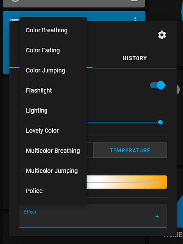

Thanks everyone in this thread. I was able to use the instructions to half-setup the process using the standard Magic Home app to unlock the smart bulbs before setting them up.
I was also able to take apart the standard Broadlink component in Home Assistant and support the standard effects for these bulbs and add the ability to define your own.
Extract this folder into your custom_components directory. All the alterations are in light.py, add effects into the MY_EFFECTS list.
This is for Home Assistant version 2022.7.3 and your mileage may vary, I’m not proficient enough with Git to submit a request
