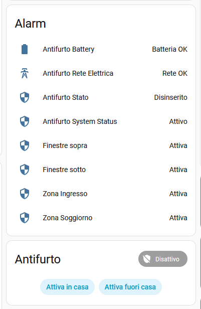

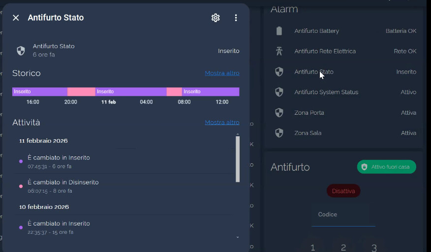

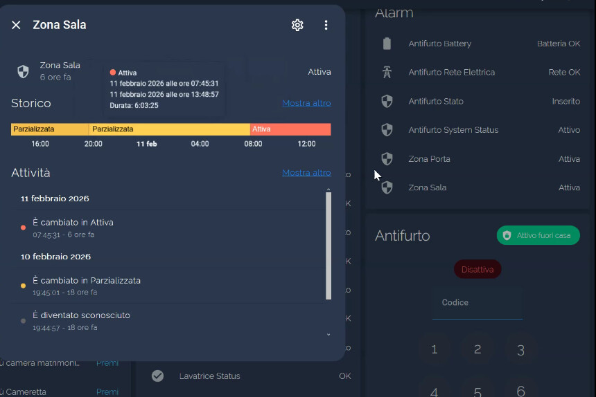

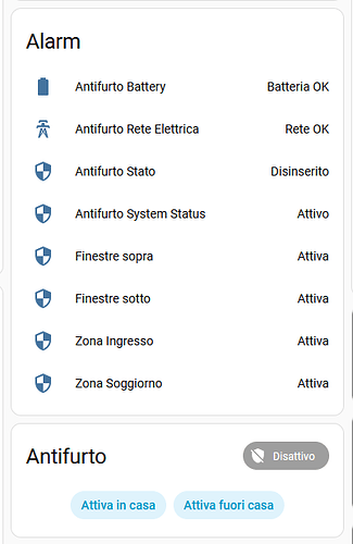

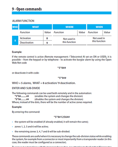

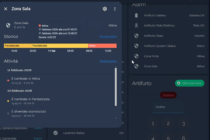

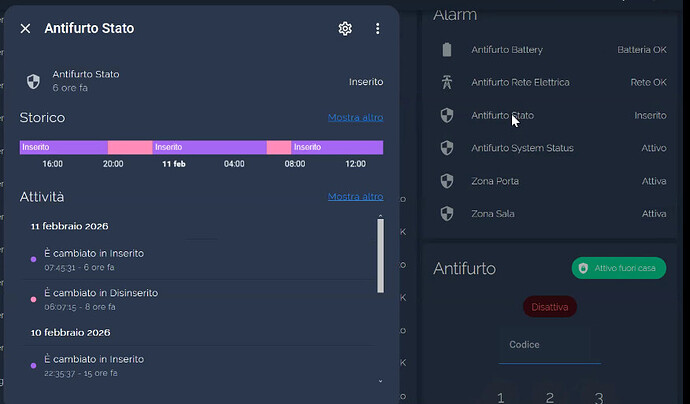

@anotherjulien , I found the language to control an alarm
Can you add this function to your integration?
the alarm system don’t accept this frame directly form bus
Theare are some workaround for do it.
It's mandatory that between scs auto and alarm scs there is a F422.
Thus you need to do some configuration on 3485/3486 to activate or deactivate alarm.
My solution (Sdomotica) do it and more
It's possible also turn on only limited zones and activate home_stay and away_stay for e.g.
thanks for your answer. I have a F454 server/ I don't know scs auto and scs there is a F422. What is it?
Is an hardware to link the burglar system with home automation system
