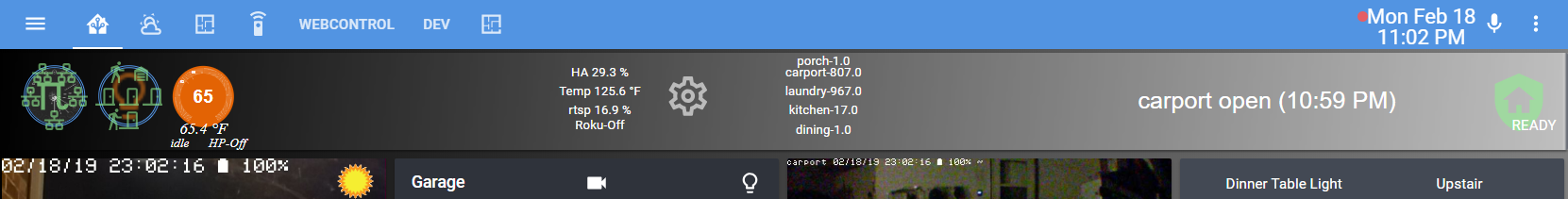

Lovelace badge+notification banner
Playing with Lovelace, this is a proof-of-concept using a banner to combine badges and message/notification.

Have fun :slight_smile:

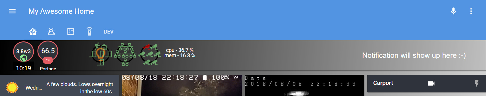

[Version 2]
Got some free time today…
[Version 2.1]
Added animated gif for state ‘on’ (red dash circling 5th badge :grin:), custom thermostat-card, column-card
picture-elements card: local variables to set relative position of ‘badges’, changed unit % to vw for better scaling across devices
To do: figure out scaling of picture-elements card size across devices, show/hide ‘badge’ based on entity state ( tried monster-card, won’t work inside picture-elements card)

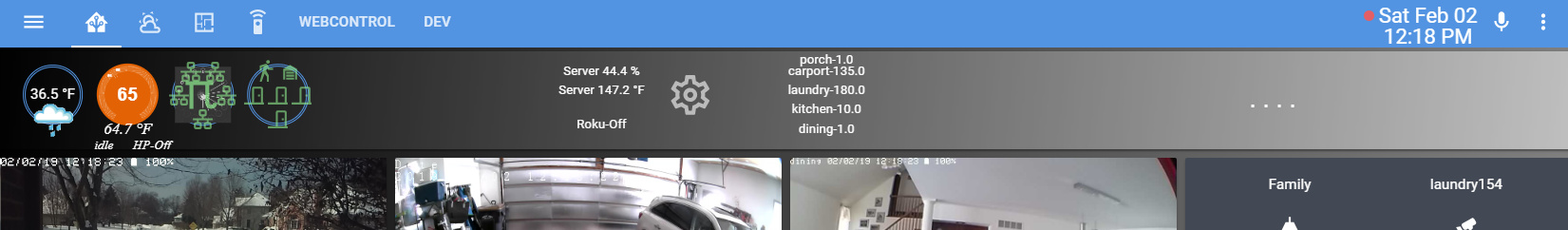

[Version 2.2]
Added compact-custom-header compact-custom-headerto save screen space on top. Tested moving the banner setup under a conditional card to hide/show banner, works fine.
[Version 2.3]
Added AlarmDecoder badge to simplify arm/disarm/monitoring
[Version 2.4]
  • Added weather badge (color is temperature-based) using config-template-card
  • AlarmDecoder badge dynamic icon using same config-template-card

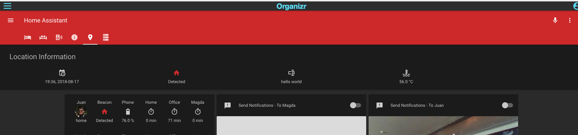

Looks nice. This gentleman created a custom card that can simulate a banner
How did you get badges?
Column-card did not create the banner, it make use of panel:true, 1st card will be full width and then let the cards under the 1st one auto flow based on screen size/orientation.

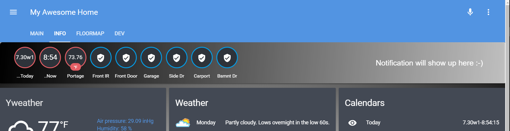

how did you change the badge css (red/green circle).
Thanks,
The ‘green’ (actually the primary color of the theme) circle is created from border-radius/border under style here:
- type: image
entity: sensor.local_date
state_image:
“open”: /local/lightbulb-outline.png
“closed”: /local/lightbulb-outline.png
filter: opacity(0)
style:
border-radius: 100%
border: var(–primary-color) double 0.2vw
The state_image does not matter here since filter: opacity(0) make whatever it is ‘disappear’ and showing only the border/circle.
I have theme change periodically and wanted the badges to look part of the theme, so I set the border color to var(–primary-color). You can set border to any color you want, just replace var(–primary-color) with a color name.
The red circle is actually an animated gif loading , I overlay that on top the ‘green’ circle image:
- type: image
entity: binary_sensor.motion
state_image:
“on”: /local/loading.gif
“off”: /local/loading.gif
state_filter:
‘on’: opacity(1)
‘off’: opacity(0)
style:
border-radius: 100%
I wanted the red circling to ‘appear’ only when the binary_sensor.motion is on, so I used opacity(0) to make it ‘disappear’ when off.
These 2 images have to been defined in this order to have the correct overlay result.
Have fun.

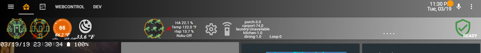

Getting the state-badges to align was a minor pain, but I got it working somehow, with the exception of the gap between the first and the second badge, which is smaller.
But my problem is the friendly_names of my sensors, which in case of the DWD weather sensor come from the sensor-attributes so I can’t change them in customization. This wrecks the panel pretty much:
Does anyone have an idea how to style around this?
That’s one of the reasons I do ‘composite’ badges instead of limited by state-badge design.
If the friendly_name can be changed in config or customize.yaml, that would be easiest.
Otherwise, reconstruct it with:
  • type: image (for circle, example for border above post),
  • type: label (for the text/value in and outside the circle),
  • type: state-icon (optional)
I highly recommend plan-coordinates for positioning/sizing in picture-element.
You mean as you explained in the post about badges and animated gifs?
Anyway, I got around the very long friendly names that I unfortunately can’t change in customization - I simply created a value_template-sensor that gives me the state of the real sensor, now I can set a friendly name as I like.
Yes, I layered different types (icon,label,etc) to look like a badge.
