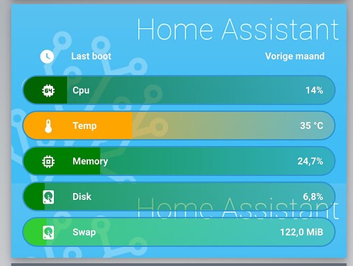

rebuilt my Home Assistant card to use regular entities card (because of the current bard-card being unmaintained.) It isnt the same, but it does have a nice ring to it. Picture needs some further tweaking (so it doesnt repeat and still is the correct size/proportion.)
and a variation with some tighter paddings, so the individual entities have a bit more space horizontally. can also change margins:

or add a bit of border, alike the original bar-card:
          border-radius: 24px; /*7pt*/;
          border: 2px solid rgb(49,150,207);
          border-shadow: 2pt;
final touch for now: add a bit more color to the rest bar, setting the percentage to 0.6 in the linear -gradient:
            linear-gradient(to right, rgb({{bar}}) 0%, rgb({{bar}}) {{perc}}%, rgba({{bar}},0.6) {{perc}}%, rgba({{bar}},0.2) 100%);
since this now is no longer a bar-card, I wont pursue here,
(I want some common mods that apply to all individual entities moved to the top card mod if possible) but given the fact the original was made with bar-card elements in the picture-elements card, I figured it to be relevant

Yaml for some common row height and icon size on the individual entities

better:
