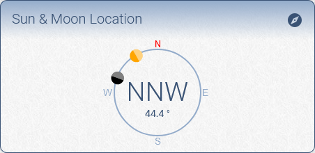

That’s a wind compass, not a wind rose. See this card instead, very customisable: Compass Card - Points you in the right direction 🧭
Screenshot 2024-09-26 at 13-27-00 Overview – Home Assistant
Screenshot 2024-09-26 at 13-27-29 Overview – Home Assistant
Ah, yes. I do like the wind rose as well that was the plan to do both. Great know that exists! Thank you.

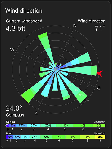

Released version 1.9.0
Feature:
  • display entity states in the corners around the windrose.
Fixes:
  • when wind speed is calm for longer time and there are no leafs to display, show the legend circles with default percentages.
  • when during configuration of your card an error occurs an SVG element was added to the DOM. Fixes #79
  • when compass direction (for auto rotate) is undefined, default to north, 0 degrees.
Add this configuration:
corner_info:
  top_left:
    label: Current windspeed
    unit: ' bft'
    color: 'red'
    entity: sensor.wind_gust
  top_right:
    label: Wind direction
    unit: °
    entity: sensor.wind_direction
  bottom_left:
    label: Compass
    unit: °
    entity: input_number.compass
I forgot to update the Readme. Will do this later today.
