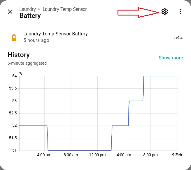

Took me awhile to find this and learn how to use the ā€œhiddenā€ option. I think it would be helpful to add it to the FAQ or other documentation in that first post.
@mlindstrom
Yea I know, Home Assistant has so many options. Thanks for your suggestion.
Blacky :grinning:
FAQ - How to hide a battery
Go into settings / devices & services / click on the entities tab at the top and search for your batteries. Click on the entity you would like to hide and then select the cog wheel
Deselect the visible option and update it. Your battery will now be hidden.
Enjoy
