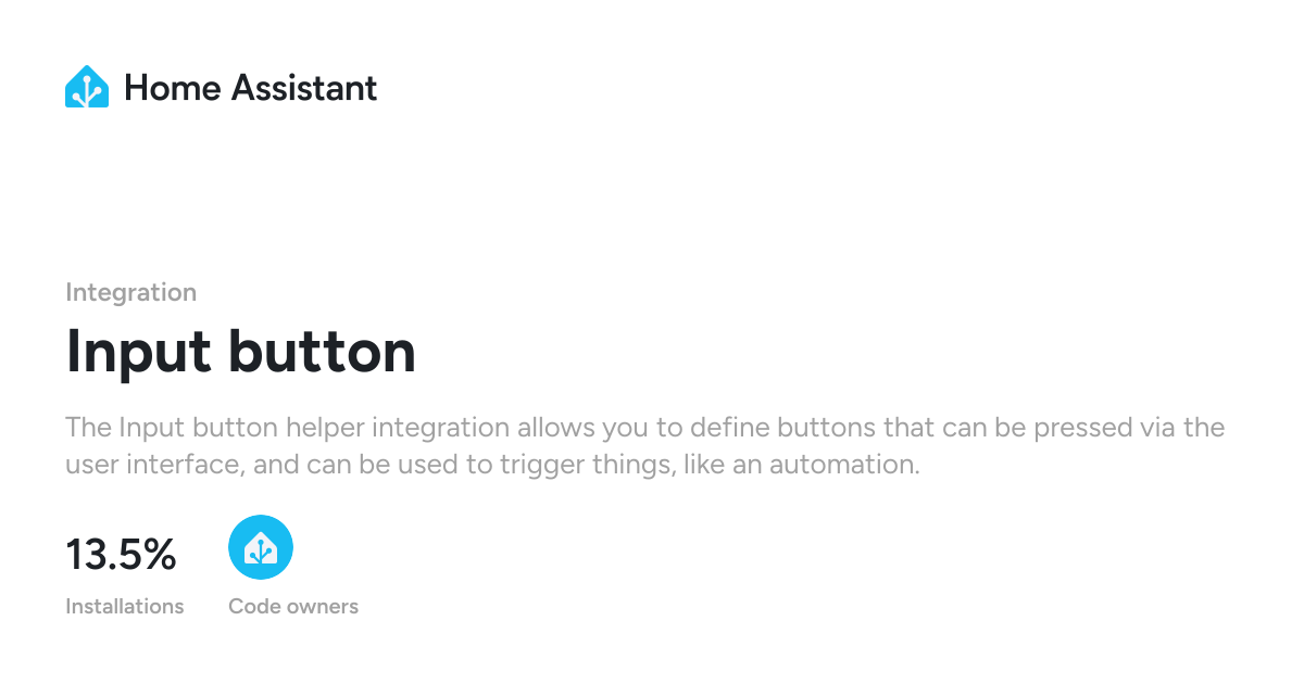

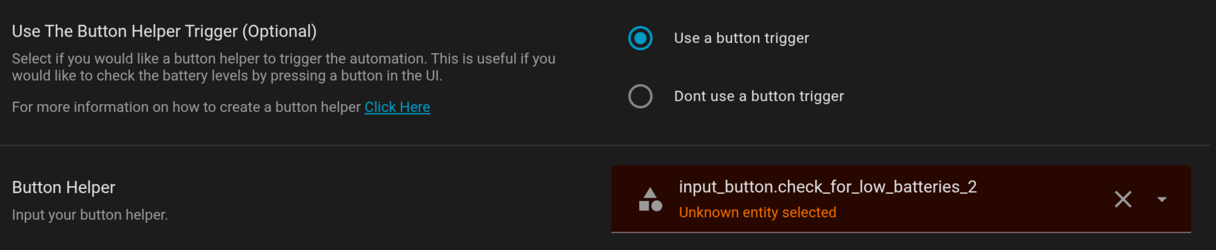

first time user and think the idea is great, but I can’t get past setting a helper. I added a button helper and it didn’t show here so I tried creating a new one from the dropdown you have for button helper and none work.
I must be missing something obvious!
of course, my original button that I created and the one created using the dropdown in your form are now visible. sunspots are heavy today!
Do you have input_button enabled in your configuration.yaml?
Be sure to restart Home Assistant after you edit that file or the change won’t be loaded into memory.

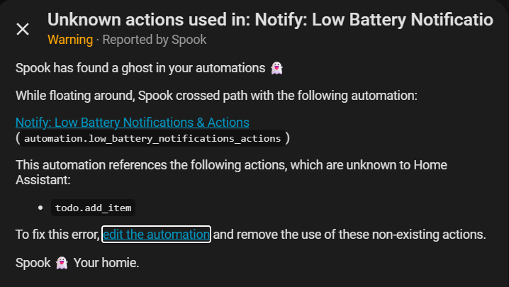

Spook is finding an error in this BP in the last few days:
This is on HA 2026.4.2
I can’t see how to fix this via the automation BP editor.
