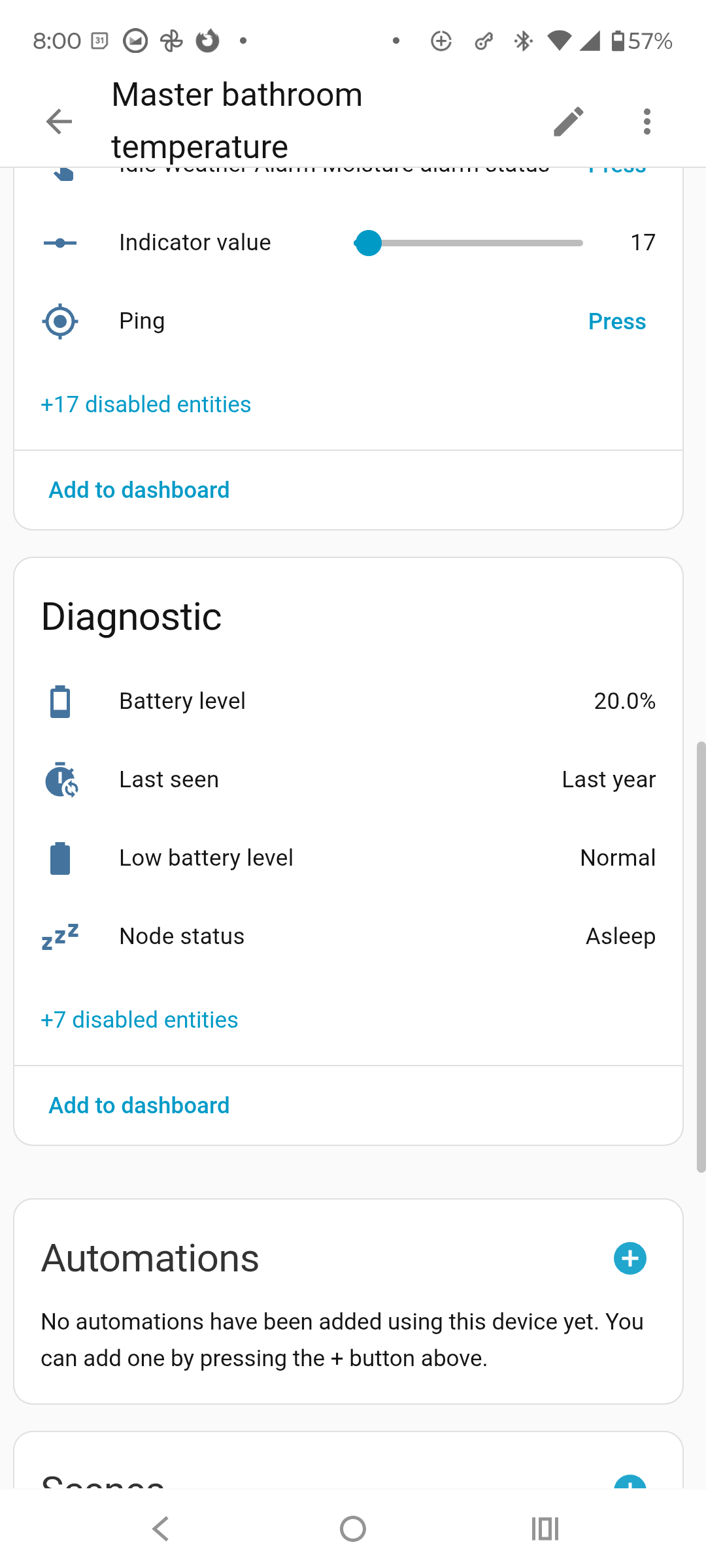

First of thanks for this automation! I was wondering if you could add last seen functionally. I had a z-wave device run out of power and I never realized it because the temperature, humidity, and battery level values always display the last known value!
It would be great if the automation could ping if the last seen is longer than some configurable value. I would also love to use this feature to see if my hard wired z-wave devices ever go offline.

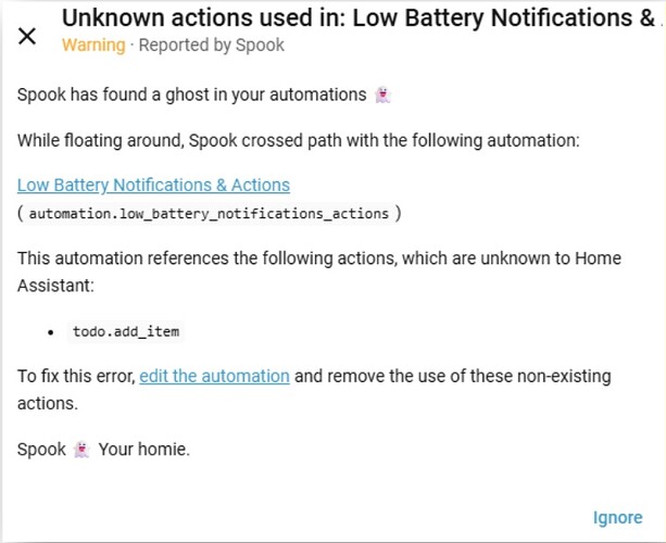

@clowgg
Yeah this is known and we have posted about this. It is just because you haven't installed the ToDo integration into your HA. You can ignore it or install the ToDo integration developed by HA. Here is the FAQ on it click here.
Blacky :grinning_face:
