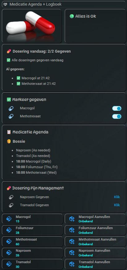

there ya go!..using my own cards a litttle tho... :slight_smile:
and removed the name stamp in code in marked given...
the left pill pic shows now red cause it was triggered....
normally it shows the red as black transparant.....
anything worked like a charm!
rock on fr0styh0e!!
That looks fantastic, love seeing it dialed in with your own cards!
And nice, you beat me to the "already given" tweak, dropping the name so it reads "Macrogol at 21:42" instead of leading with the patient. That's exactly what was bugging you (and another user) earlier, so I'll make med-first the default in the bundled card too (keeping the patient name only when there's more than one patient). The red-pill-on-trigger card-mod touch is slick.
Really glad it all came together. Thanks for putting it through its paces and for the sharp feedback, it genuinely shaped the last few releases. Rock on! :call_me_hand:
