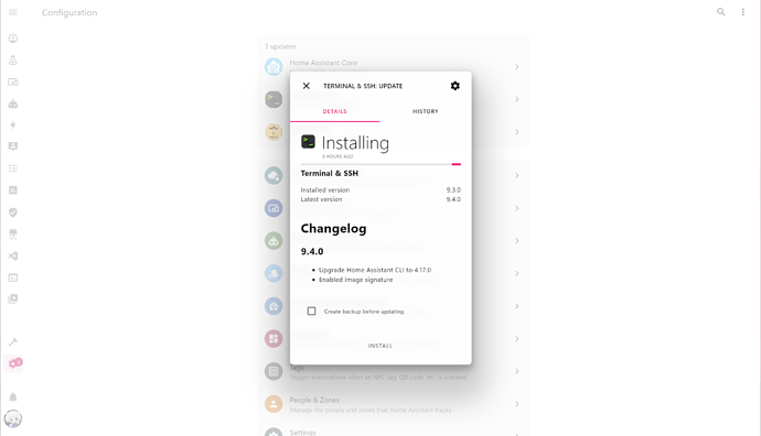

Metro style has a more vibrant color contrast, sharp corners, and a true black background great for AMOLED screens. Based on the design of Windows 10.
Fluent style has subtle shades of colors, rounded corners, and background colors adjusted to be easy on eyes. Based on the design of Windows 11.

Display your home automation status with distinct and bold typography using Segoe UI or Segoe UI Variable fonts. Use Light and Dark Modes natively. Dark Mode has a true black background great for AMOLED screens.
Switch between 6 color themes. Also adding new themes is relatively easy thanks to YAML Anchors. Revamp your More Info cards and various system UI screens to look extra clean and slick.
