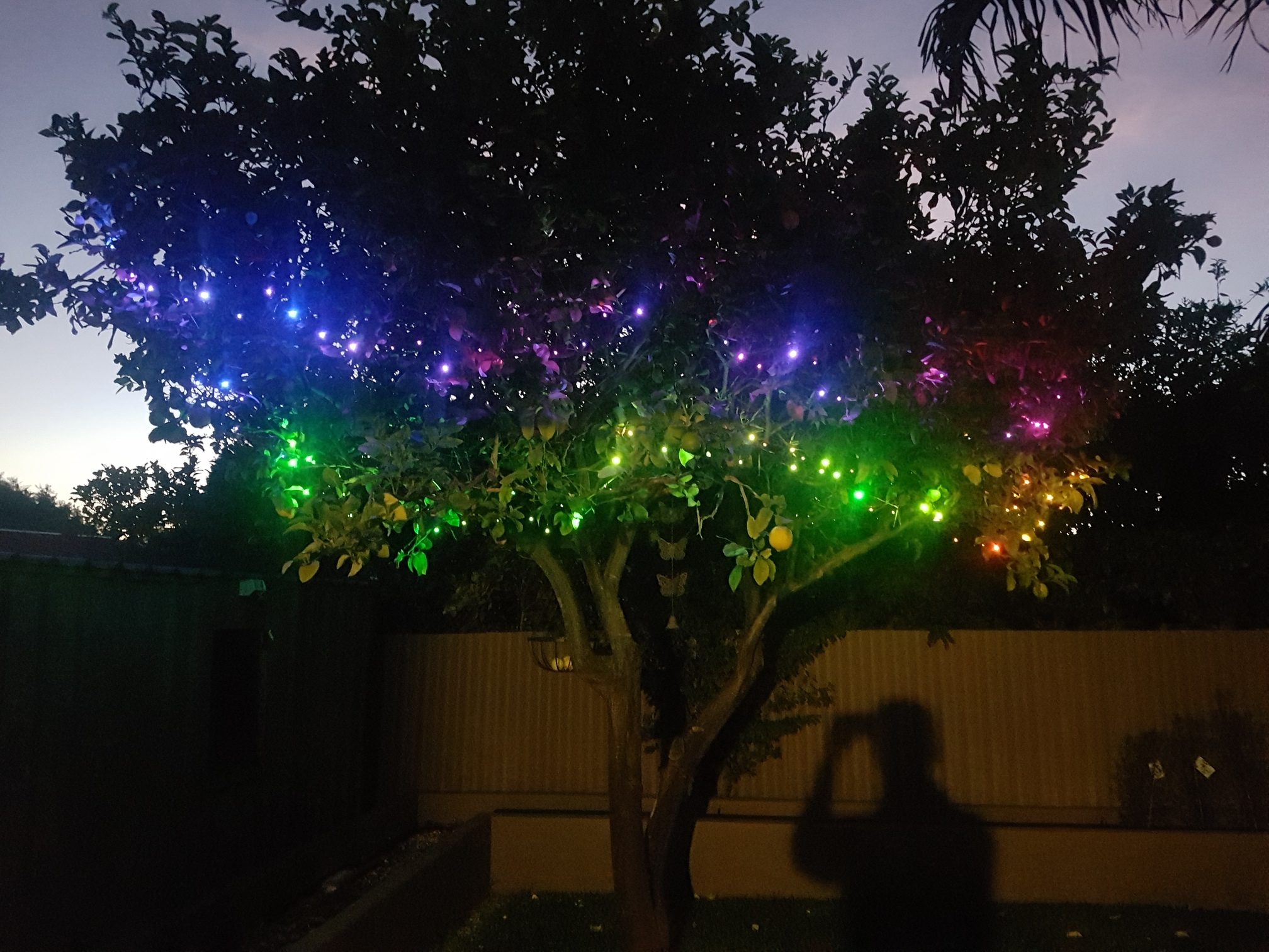

That’s awesome! I’ve been meaning to post a video of these LED’s in action because previous explanations of how they work didn’t seem correct and I was hoping it might help someone crack the secret. Did you figure out a way to do the standard firmware effects?
Thanks to Ssieb in Discord writing an new custom component for me, we have been able to get full operation of the light. Full brightness and Colour Temp changing.
What effects does the standard firmware have?
Ok, so there is definitely something technical going on here. Its not just a case of PWM signals. The string can have a multitude of colours on at the same time.

Do you have a string you can open up and see how it’s wired? Are the colors always in the same place or can an individual light have multiple colors?

The LED’s run on a 2 wire system (literally only 2 wires coming out of the controller, pics in previous posts about these) and yes an individual LED can be any colour.

Did you open it up to see what kind of circuit it’s using? Do you have an oscilloscope to check the signals from the ESP?
It’s all in the previous posts above. I haven’t personally opened one up and unfortunately don’t yet have an oscilloscope (one has been ordered but will take a while). There is a link in this post which we thought is how they work however my findings regarding the LED’s being able to do multiple colours along the string at the same time would suggest (at least in my head) that this isn’t how these work…
Right, I’ve read the other posts. You clearly have a different string than the other ones that were discussed here. That’s why I was hoping you had looked inside yours.
Its the same string, just a single length rather than being made into a Christmas tree shape. Its the same brand etc and still only has 2 wires. From what I can tell all the models are the same other than the “shape” they unold to.
