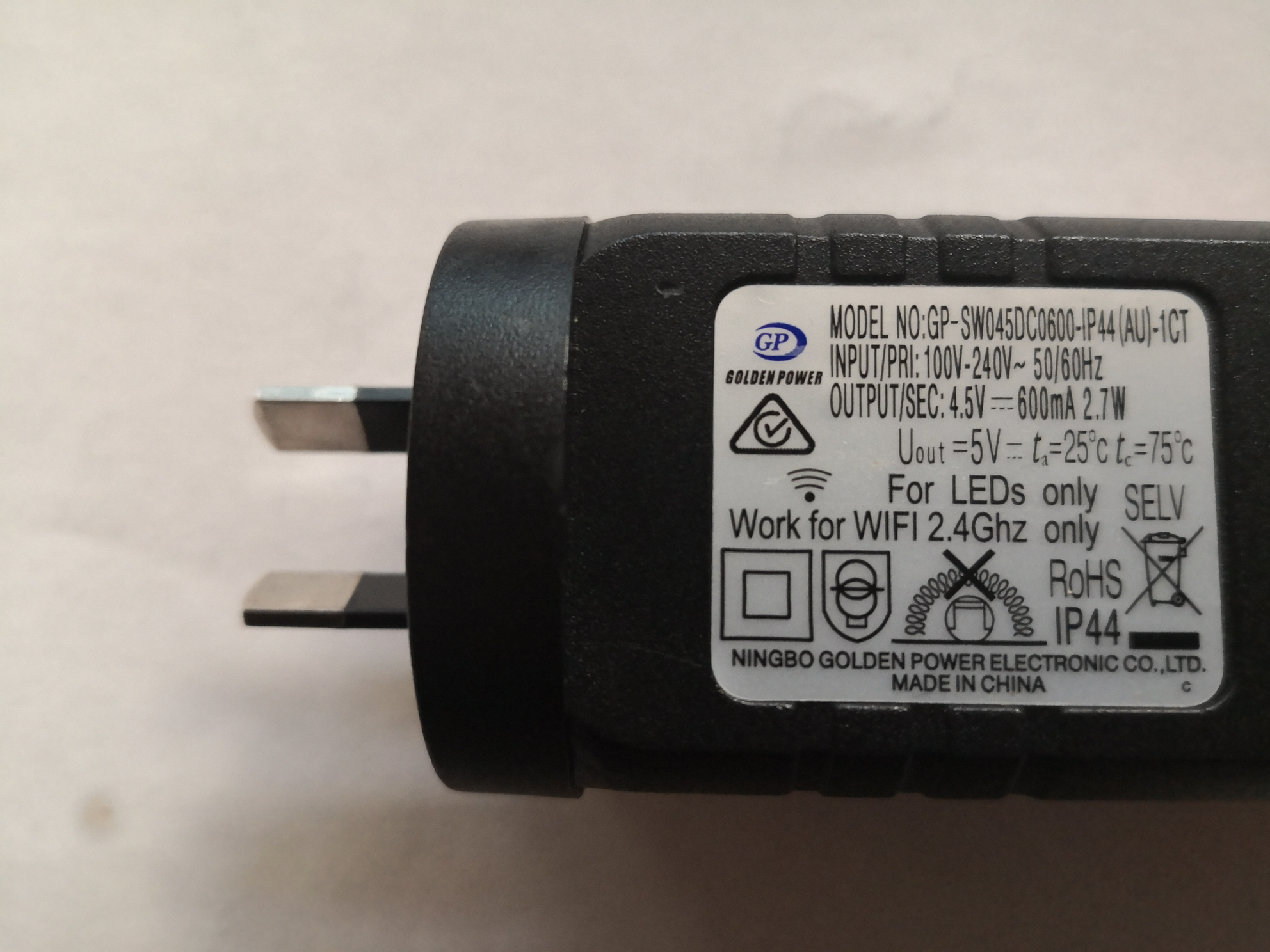

So we got some of those mirabella lights. Tried them in the genio app to get a feeling for them. Removed them from the app. Booted up a pi with fresh install of buster lite and OTA latest tuya convert.
The plug flashes green(slow) when no wifi ap, had to hold the button for fast green light flashing. loaded tasmota 7.0.0.3(default) with tuya convert.

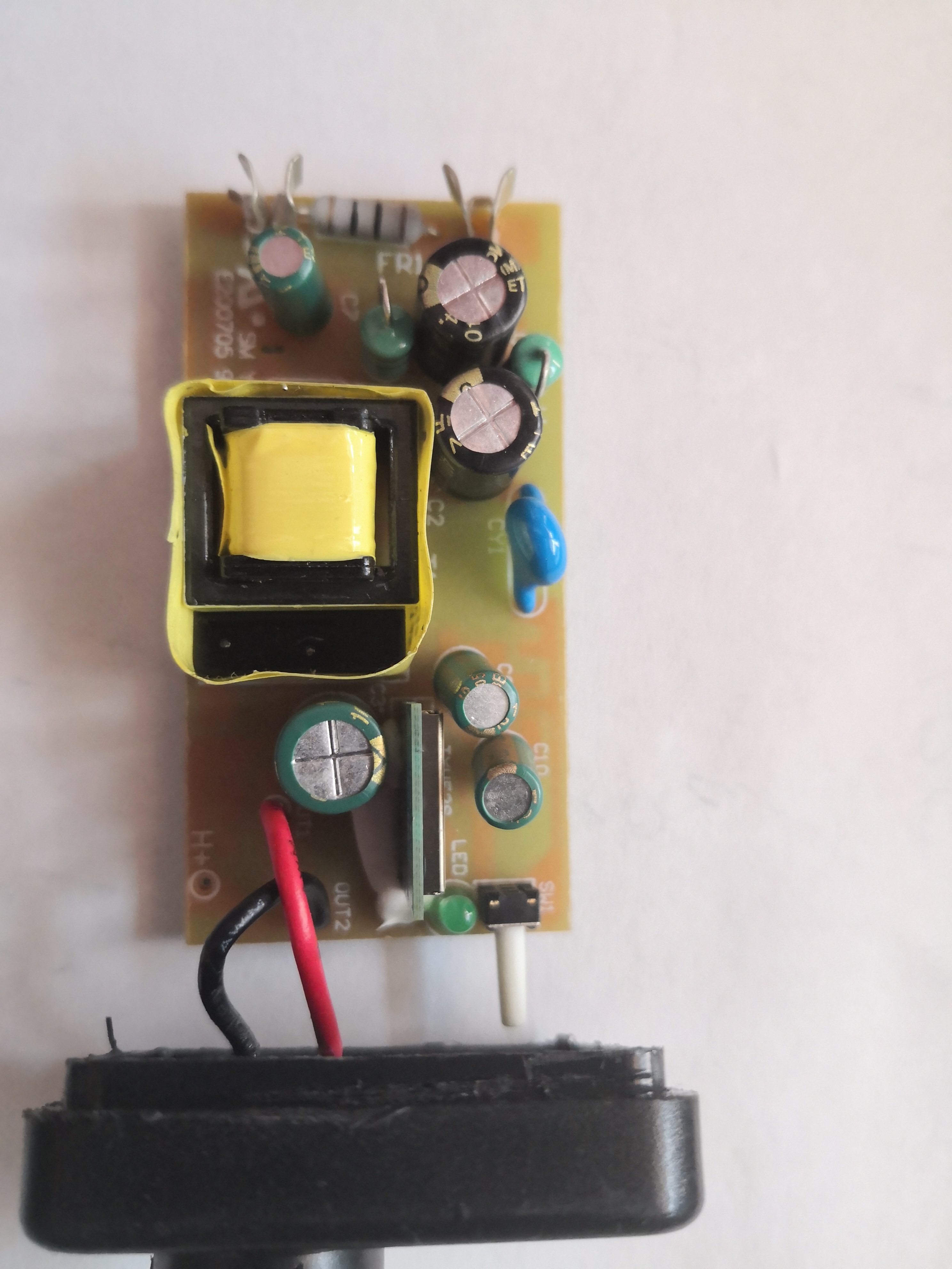

So in the meantime if you want more than 1 scheme… leave them in the genio app. Oh and I didn’t need to pull it apart to flash it, just wanted a look.
