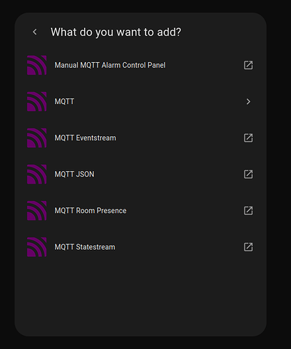

I’ve done some digging. It seems like the MQTT integration used to be able to handle json responses when the schema key was set accordingly. Now there seem to be a bunch of MQTT integrations, including MQTT_JSON.
However, that integration needs manual setup in the configuration.yaml, including a list of devices, which defeats the auto discovery.
So I don’t know how to proceed at this point. Can auto discovery be used with MQTT supporting json schema? I’d prefer if I didn’t have to revert to an old HA version to be able to use the discovery feature.
