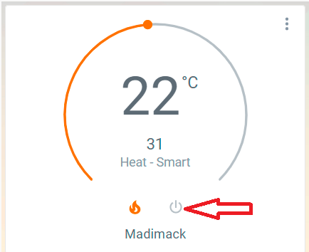

@brix29 Can i please ask you to test something for me.
Can i please ask you to click the power button on the lovelace card and let me know if that powers on your inverter and then when pressed again, powers it off.
I am finding that my config does not power the inverter ON when I click the power button (when the inverter is in an unpowered/not running/off state), but then when it is in an ON/HEATING state, when i press the power button, the device does turn OFF
In order for me to turn the inverter on using Home Assistant (from an off state), i click on the three buttons at the top right of the card,
On the new window which appears, I click the dropdown associated with the Operation field and select Heat.
Hi Michael,
it’s not a toogle button. It’s just “off”. The fire is “on” in my case.
BR Axel
Thanks…
This is the case for me too, i actually didn’t try to click the Fire icon previously, but now have and you are correct, it does turn the unit ON.
