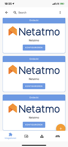

this is my integration page at the moment. 16 (!) discovers netatmo entities despite I have only 2 cams. I cant ignore it and tried it in the configuration.yaml to ignore but it doesnt recognize the platform.
Any idea what i can do?

I can’t remove it. The only option I have is to configure it. The three dots allow me only to see the already ignored integrations.
Do you have any Netatmo stuff configured right now?
Nope. Here is the screenshot.
Ok, then I need some debug info to get to the bottom of it. I’ll get back to you on this.
