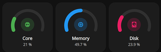

Got:
before
Want:
Code:
type: grid
square: false
columns: 2
cards:
  - type: custom:stack-in-card
    cards:
      - type: custom:apexcharts-card
        chart_type: radialBar
        series:
          - entity: sensor.braavos_cpu_load_user
            color: rgb(76, 175, 80)
            max: 90
            show:
              legend_value: false
        apex_config:
          plotOptions:
            radialBar:
              offsetY: 0
              startAngle: -108
              endAngle: 108
              hollow:
              dataLabels:
                name:
                  show: false
                value:
                  show: false
              track:
                strokeWidth: 80%
                margin: 0
          legend:
            show: false
          chart:
            height: 240
      - type: custom:mushroom-entity-card
        primary_info: name
        secondary_info: state
        icon_color: green
        layout: vertical
        card_mod:

Something like this?
type: grid
square: false
columns: 3
cards:
    cards:
        series:
          - entity: sensor.processor_use_percent
            max: 100
            show:
              legend_value: false
        apex_config:
          plotOptions:
            radialBar:
              offsetY: 0
              startAngle: -108
              endAngle: 108
              hollow:
              dataLabels:
                name:
                  show: false
                value:
                  show: false
              track:
                strokeWidth: 80%
                margin: 0
          legend:
            show: false
          chart:
            height: 170px
        primary_info: name
        icon_color: green
        layout: vertical
        card_mod:
          style: |
            ha-card {
              top: -63px;
    card_mod:
      style: |
        ha-card {
          height: 158px;
    cards:
        series:
          - entity: sensor.memory_use_percent
            color: rgb(33, 150, 243)
            max: 100
            show:
              legend_value: false
        apex_config:
          plotOptions:
            radialBar:
              offsetY: 0
              startAngle: -108
              endAngle: 108
              hollow:
              dataLabels:
                name:
                  show: false
                value:
                  show: false
              track:
                strokeWidth: 80%
                margin: 0
          legend:
            show: false
          chart:
            height: 170px
        primary_info: name
        icon_color: blue
        layout: vertical
        card_mod:
          style: |
            ha-card {
              top: -63px;
    card_mod:
      style: |
        ha-card {
          height: 158px;
    cards:
        series:
          - entity: sensor.disk_use_percent
            color: rgb(233, 30, 99)
            max: 100
            show:
              legend_value: false
        apex_config:
          plotOptions:
            radialBar:
              offsetY: 0
              startAngle: -108
              endAngle: 108
              hollow:
              dataLabels:
                name:
                  show: false
                value:
                  show: false
              track:
                strokeWidth: 80%
                margin: 0
          legend:
            show: false
          chart:
            height: 170px
        primary_info: name
        icon_color: pink
        layout: vertical
        card_mod:
          style: |
            ha-card {
              top: -63px;
    card_mod:
      style: |
        ha-card {
          height: 158px;
Best way to do this would be to use state-switch card, use url hashes as the states and then define the tap action of the buttons to navigate to the browser hash. Then it’s completely local to the device.
