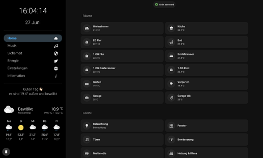

Many thanks for this fantastic implementation. I love it. When did you plan the implementation for the climate card? I can’t really wait :star_struck:. Any way … fantastic work!
Following a few Screen’s of my Tab Dashboard created with Mushroom
