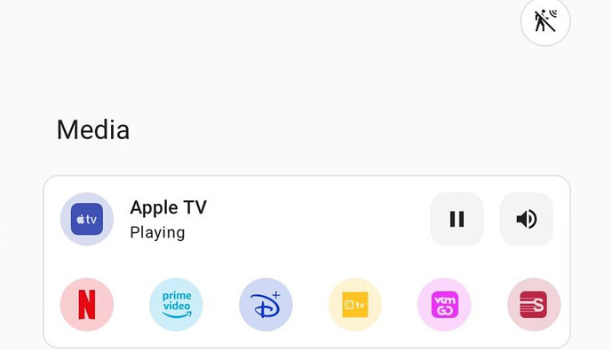

Can anyone help me with this? Any idea to create this media card showing all the apps under Apple TV here (Netflix, Prime Video etc)? I added mine in but not sure how to show those app. Thanks in advance!
do you want to recreate that card? is that what yours asking. I can do something like that for you later if no one has replied before then
Yes, if you can give me a hint that would be great, thank you. I was just trying to recreate the same one. I left a message on original thread on Reddit but the post was old so OP didn’t replied. This is how my current card looks like, btw is that normal behavior for the turn on/off button only works to turn off the TV. Tried turning it on with that power button there but it didn’t do anything.
Screenshot 2024-05-23 at 2.33.07 PM
I use WoL (wake on lan) in the configuration.yaml to turn the TV on.
do you have separate entity’s for controlling netflix etc or is that through a service call for the TV.
OK I can recreate the card easy enough. we just need to workout how to edit the Netflix buttons. to work for you.
feel free to private message me so we don’t fill the topic with unrelated mushroom posts

incase anyone wanted the code.
it’s done on my LG TV WebOS with a service call to the source list. stack-in-card, card_mod and custom brand icons
type: custom:stack-in-card
  - type: vertical-stack
      - type: custom:mushroom-media-player-card
        entity: media_player.lg_webos_tv_uk6470plc
        volume_controls:
          - volume_mute
          - volume_buttons
          - volume_set
        media_controls:
          - play_pause_stop
          - on_off
        use_media_info: false
        layout: horizontal
        icon_type: entity-picture
        card_mod:
          style: |
            ha-card {
              border: 0px;
      - type: horizontal-stack
          - type: custom:mushroom-template-card
            primary: ''
            secondary: ''
            icon: mdi:netflix
            icon_color: red
            tap_action:
              action: call-service
              service: media_player.select_source
                entity_id: media_player.lg_webos_tv_uk6470plc
                source: Netflix
            card_mod:
              style: |
                ha-card {
                  border: 0px;
            primary: ''
            secondary: ''
            icon: phu:prime-video
            icon_color: light-blue
            tap_action:
                source: Prime Video
            card_mod:
              style: |
                ha-card {
                  border: 0px;
            primary: ''
            secondary: ''
            icon: phu:apple-tv
            icon_color: yellow
            tap_action:
                source: 'Apple TV '
            card_mod:
              style: |
                ha-card {
                  border: 0px;
            card_mod:
              style: |
                ha-card {
                  border: 0px;
            primary: ''
            secondary: ''
            icon: phu:disney-plus
            icon_color: blue
            tap_action:
                source: Disney+
            primary: ''
            secondary: ''
            icon: phu:youtube
            icon_color: red
            card_mod:
              style: |
                ha-card {
                  border: 0px;
            tap_action:
                source: YouTube
            primary: ''
            secondary: ''
            icon: phu:bbc
            icon_color: orange
            card_mod:
              style: |
                ha-card {
                  border: 0px;
            tap_action:
                source: BBC iPlayer
