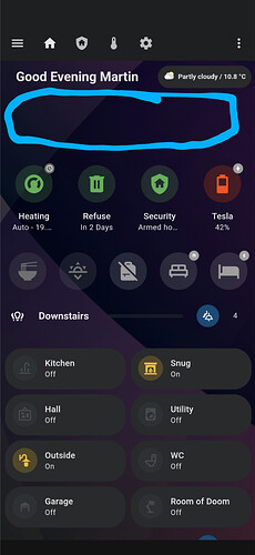

I’m trying to get my dashboards all working with the new sections view. All seems pretty good, but I’m having an issue where conditional chips are leaving a gap when they shouldn’t be in view.
You can see the large gap that shouldn’t really be there in the image.
The second image is in edit view to show the chips.
Anyone else having this issue?
Yes when I cast to a nest hub the gap shows up but not on the home assistant app or a browser. I have a pixel tablet hub as well, same behaviour cast gap is there, app displays as it should.

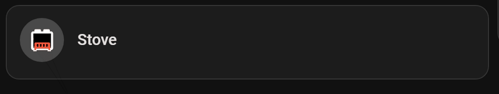

Is it possible to animate the stove icon?
All Mushroom Icons can be animated in some form. You’ll have to describe what animation you’d like the stove to have.

Been browsing that thread but can’t figure out how to animate when the stove top or oven is in use.
Definitely something I can assist with. Do you have 2 different sensors that tell you when the oven and stove top are on/off?
As an example
chrome-capture-2024-6-12 (2)
Thanks for the birthday wishes
Yes
“sensor.range_cooktop_burner” which is either “run”, or “ready”
“sensor.range_oven_job_state” which is either “preheat”, “cooking”, or “ready”
Ok, give me a bit, and I’ll put together a solution. Do you have an idea how you’d like each section represented with activity? Colors, animation?
for the cooktop maybe animate the flame for “mdi:gas-burner”

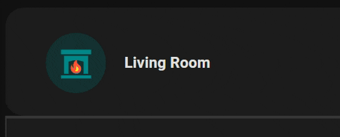

for the oven maybe animate the middle section similar to the dryer without the shaking, or maybe add the flame as you did with the fireplace.
Mushroom Dryer
That’s doable!

It’s a shame as this conditional gap for me makes it unusable. I’m hoping a fix for this comes soon somehow!

How you feel about these animations? The animations will react to the state of each sensor.
Both
chrome-capture-2024-6-12 (12)
Oven only
chrome-capture-2024-6-12 (11)
Stove Top Only
chrome-capture-2024-6-12 (10)
