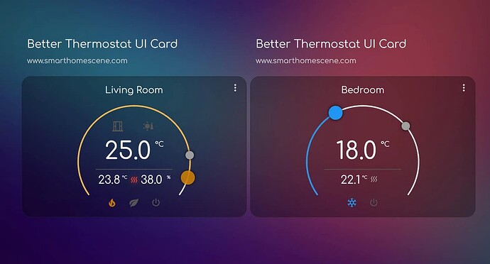

Under climate card you wrote ā€œno sliderā€. But there is a slider. How can I change the color and the thickness of this slider?
Right now its like this:
And i want it to look like this:

This is the mushroom climate card:
no slider. what you are showing is either the more-info dialog for a climate entity, or the built in thermostat card for homeassistant. either case not mushroom related.
EDIT: actually its the better thermostat card:
still not mushroom related.
Oh you are right. Do you maybe know where I can find the css entities for that?
play around with this:
card_mod:
  style:
    bt-ha-control-circular-slider$: |
      .arc {
        stroke-width: 10px !important;
      .background {
FYI effectively identical pathing for the built in thermostat card:
card_mod:
  style:
    ha-state-control-climate-temperature$:
        .arc {
        .background {
exactly! Manny manny thanks for this
Awesome, thank you so much!
