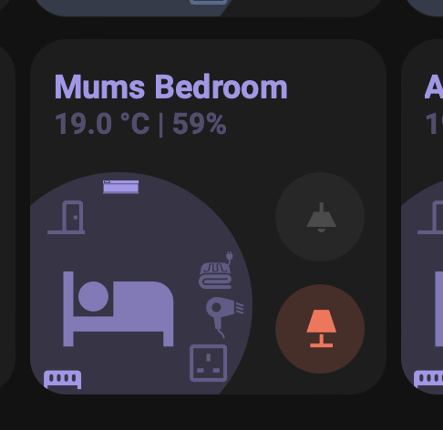

I have colored hue lights in some rooms. How can I set the room card color or the light switch on the card to match the light color?

atm the card does not support the card changing color to the main entity color (Iâll look into that), but you can set the Entity icon to the color of the light.
entity_4:
entity_id: light.mums_bedroom_lamp
ulm_custom_card_andyblac_room_use_light_color: true
